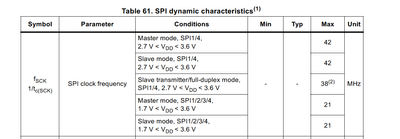

Can we achieve such higher baud rate of 4.8Mbps in stm32f401re
2024-07-10 11:45 PM
See ds F401 :
For 12b ADC set SPI to 16b data (half-word, if using DMA.).
