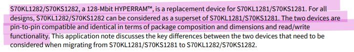

from Infineon AN229785: Migrating from S70KL1281/S70KS1281 to S70KL1282/S70KS1282
It's a shame Infineon doesn't recommend a replacement part on the product page when they EOL. I thought that was standard practice.
