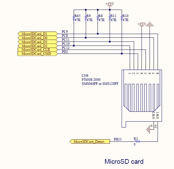

Will definitely break without pull-up resistors. 33K or 47K will suffice. You'll need to pick your own card detect pin.
I've posted the MSC and FatFs examples to the STM32F4-Discovery with a MicroSD socket. These have been posted against the forum several times.https://docs.google.com/open?id=0B7OY5pub_GfIcU1XTDFDRlptZDg
