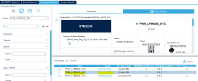

Please try to reproduce the datasheet consumption by using the example "PWR_LPMODE_RTC" available on STM32CubeMX.
This example will show you how to enter the system to different available low power modes (Sleep, Stop0/1/2/3, Standby, Shutdown) and wake up from these modes by using an interrupt from RTC wakeup timer.

Hello Aime, thanks for replying. How come there is no "PWR_LPMODE_RTC" for the stm32u5 discovery kit 2? I checked the example you suggested and the example was not very helpful. It didn't elaborate on the standards needed, it simply said the example was multi-configurable by uncommenting main.h definitions? Is there a repo or example using the actual generic drivers a user would use to enable the lower power features? @Aime

The PWR_LPMODE_RTC example on U5, is not depending on the board that you are using, it is the basic steps by steps example to show how to enter in different low power modes (Sleep, Stop0/1/2/3, Standby and Shutdown) on U5. It works on both Nucleo and Discovery boards.
Yes, you have to select the low power mode in the main.h file, and in the main.c , stm32u5xx_hal_msp.c, stm32u5xx_it.c files you will find all configurations (GPIO, System Clock, Power range...) and functions used to enter in the selected low power mode.
