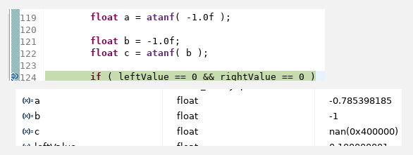

Can anyone tell me why the value of 'c' here should be NaN ??
On other platforms I get the same result for 'a' and 'c', as expected.
#include <math.h>
float a = atanf( -1.0f ); // returns -0.785398185
float b = -1.0f;
float c = atanf( b ); // returns NaN

iforce2d
Associate III
Okay this is embarrassing.
There was no difference between C and C++ so I spent all morning slowly removing things from my (rather large) project, only to discover this little gem in some 'helper' code I hadn't looked at for a very long time:
float fabsf( float f ) {
	if ( f >= 0 )
		return f;
	return f;
I don't recall making this, or why it was even necessary to make my own in the first place, or how I could have screwed it up and not suffered any problems until now, in over a year of working on this project.
But anyway, for some reason atanf finds it necessary to call fabsf (why??), but only in the case where the operand is a variable, not a literal, ie:
float a = atanf( -1.0f ); // does NOT call fabsf
float b = -1.0f;
float c = atanf( b ); // calls my broken fabsf
Thanks for the assistance Jan, sorry for the weird screwup.

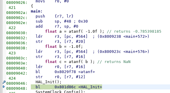

iforce2d
Associate III
hmm.... like this?
Not sure if it's relevant, but my project is using C++, not pure C.

waclawek.jan
Super User

iforce2d
Associate III
