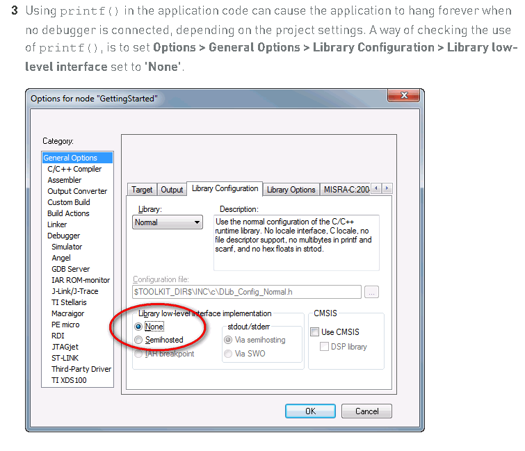

There are major differences between running an application using the C-SPY debugger, compared to running stand alone.
When debugging the application with the C-SPY debugger, a number of SFRs are set by:
When the application runs standalone these SFRs need to be set by the application in the start-up/initialization code.
This Application note from IAR gives detailed information regarding this issue fix. Let us know if this solves your issue. Thanks
https://www.iar.com/knowledge/support/technical-notes/debugger/application-does-not-run-stand-alone/

2021-10-04 12:29 AM
Hello!
thank you for your help, eventually it was the printf() calls.
