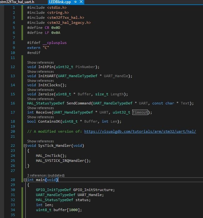

For example this runs:

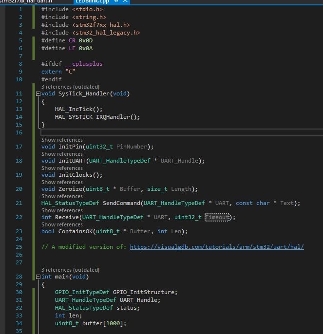

whereas this fails:

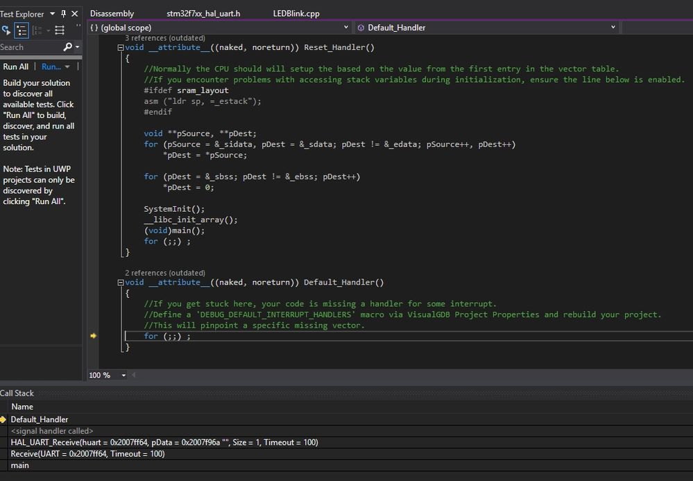

If I interrupt the failing version, I see this stack trace:

OK it's me, I'm a bozo - the extern "C" directive is required and was being applied or not applied as I moved the code body around! Declaring a prototype and ensuring it has extern "C" fixes it all!
