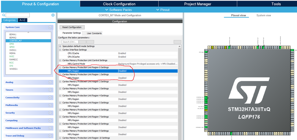

2024-06-13 9:32 AM - edited 2024-06-13 9:34 AM
Finally I got it working, I followed the codes, instruction from STM and other sources for OSPI
STM example worked fine on STM32L4P5 discovery with the same OSPI flash (512 Mbits) but never on my custom board in CubeIDE. Worked fine in Keil
Here was the problem, I had those 2 first MPU regions enabled as in examples.
I removed (disabled) it and the memory mapped mode suddenly works. It can write and read.
I am still not out of the woods, it does not write first 14 character of the string. Maybe I need some delay

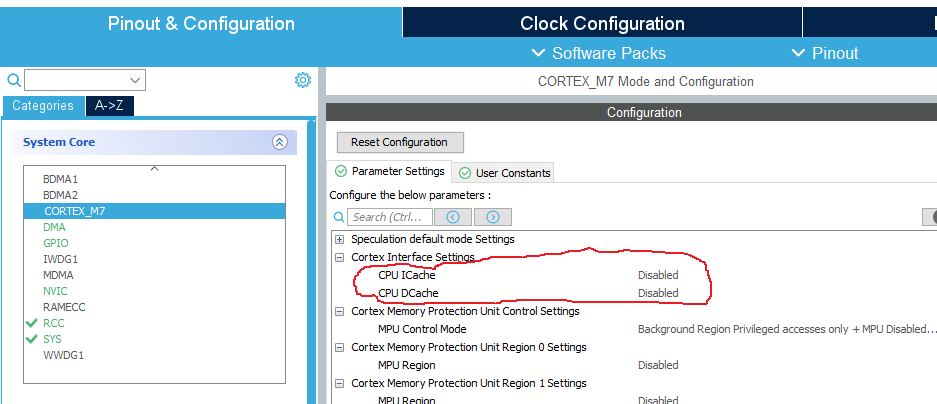

2024-06-13 11:59 AM - edited 2024-06-13 12:00 PM
I do not know you mean by local cache
the only one I see are here. disabling or enabling makes no difference.
I do have STM examples I am looking what I might be doing wrong, I cannot find anything missing. there must be something somewhere
