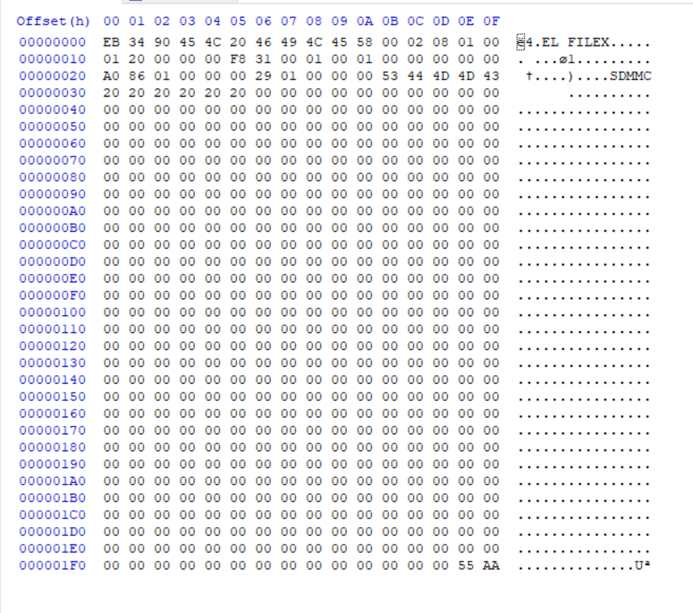

I am currently programming an eMMC(SDMMC) card with an STM32U575 microcontroller.
In 4 bit mode it works perfectly, but in 8 bit mode, I have a CRC error (HAL_MMC_ERROR_DATA_CRC_FAIL) in the HAL_MMC_ReadBlocks function called by fx_media_open.
NB: I call fx_media_format before fx_media_open.

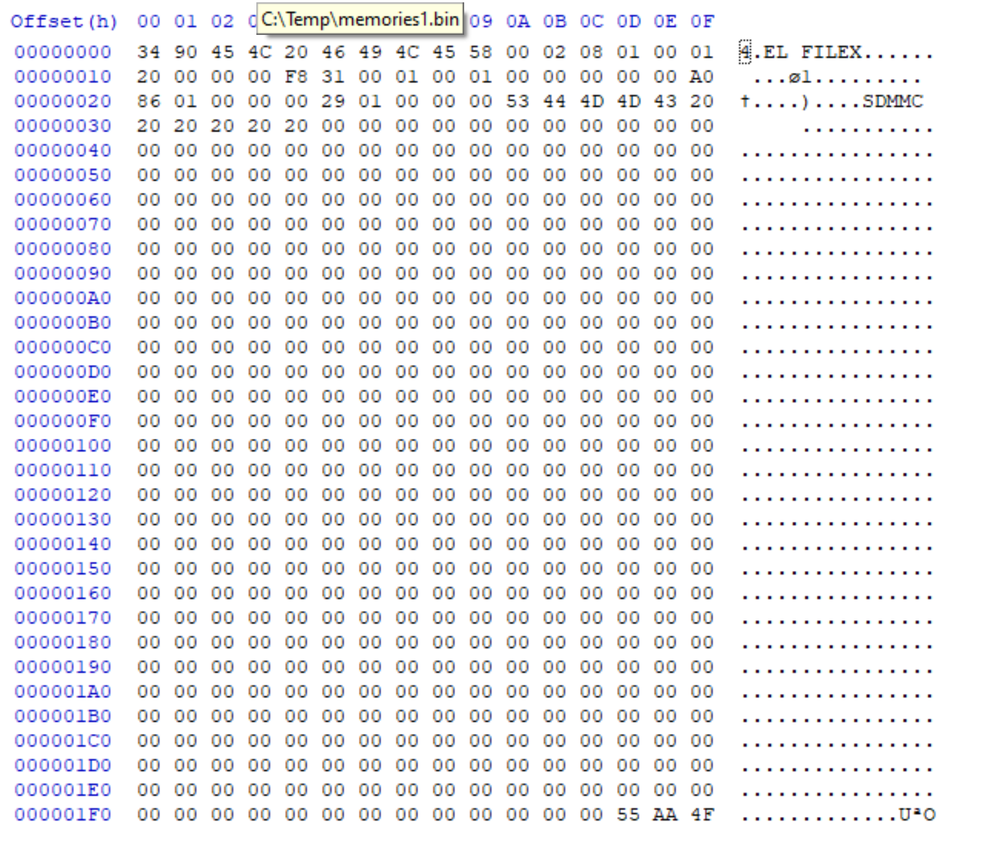

When I compare the data I get in 4 bits and 8 bits mode, the first byte is not the same.
Any idea about that error?
Thanks in advance.
It's not just different - the first byte is missing and the whole block in the second screenshot is shifted by one byte.
