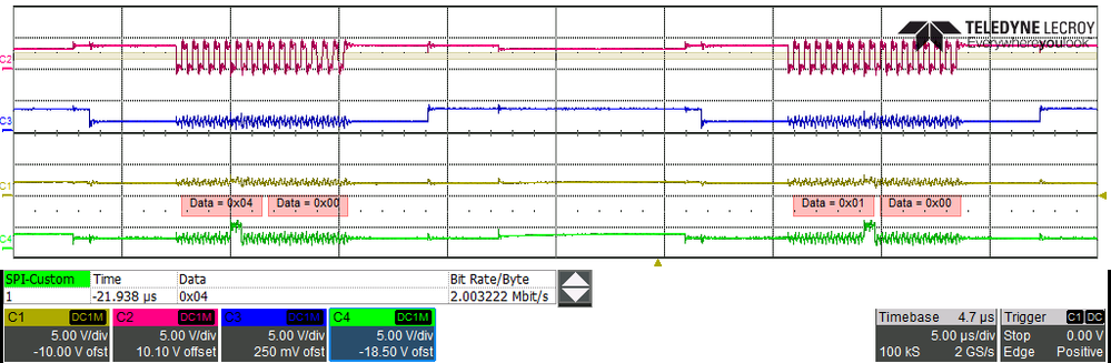

This is how my transaction looks on the scope. Clock (Red), CS (Blue), MOSI(Green), MISO (Yellow).
The signal on MISO and the received data are not as expected, I don't understand why. I believe i am doing something wrong in the initialization stage. Any useful tips or pointers would be helpful. Thanks.

Do you measure the waveforms directly on the TI board?
2022-02-24 4:49 AM
No, measured it from ST. I will try measuring from TI board.
2022-02-24 6:05 AM
This screenshot is from the TI side. SCK (RED), Data IN (Green), Data Out (Yellow), CS (Blue)
I believe the chip itself might be damaged.
2022-02-24 2:33 PM
Try with the original TI master, measuring at the same place, compare/post waveforms.
