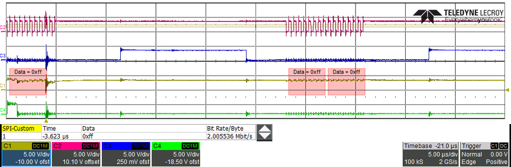

This is how my transaction looks on the scope. Clock (Red), CS (Blue), MOSI(Green), MISO (Yellow).
The signal on MISO and the received data are not as expected, I don't understand why. I believe i am doing something wrong in the initialization stage. Any useful tips or pointers would be helpful. Thanks.

Looks like the chip isn't driving the line at all. Use a weak pulldown on the line to see if it changes the value from 1s to 0s. If it does, it means you likely have a hardware problem. Consider lowering clock speed as well during debugging to eliminate that as a possible issue, especially if you have long leads.

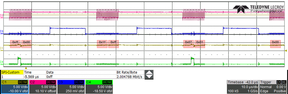

Measure directly on TI devboard. Compare waveforms taken with the TI master versus with STM32.
2022-02-24 12:49 AM
Thank you for the helpful tips, I will definitely try to reduce the wire length as far as possible. I have compared the waveform with the TI, Clock, CS and MOSI are identical. Vcc was slightly different 3.277V with TI and 3.312 with ST. And of course the MISO Line was not a noisy high signal, instead there was a valid data returning on that line.
