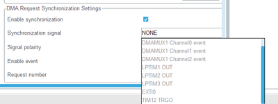

I cant use the internal ADC , as i need conversion error of less than 1mV.
does setting timer 12 for the desired delay and using dma synchronization automatically triggers SPI DMA mode without any interrupts. I dont know how this works

...does setting timer 12 for the desired delay and using dma synchronization automatically triggers SPI DMA mode without any interrupts. I dont know how this works
I have no experience with H7 devices.
Try the Cube MCU package for an example of timer-triggered SPI per DMA.
I recently dissected a SPL example showing the exac t same thing (timer-triggered SPI transfer via DMA) for the F37x, and ported it to a F303.Some modifications are probably necessary, such links between timers, DMA channels and peripherals are system-specific.

>Try the Cube MCU package for an example of timer-triggered SPI per DMA - I will look into it.
