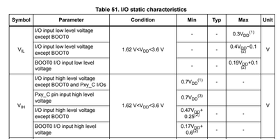

@waclawek.jan wrote:Make sure the signal has voltages for valid logic levels for your VDD.
+1
@sreyas40 wrote:i verified the signal in a logic analyzer.
Are you sure your logic analyser's logic thresholds match those of your STM32?
Would be worth also using an oscilloscope to verify that all is good in the analogue domain ...
