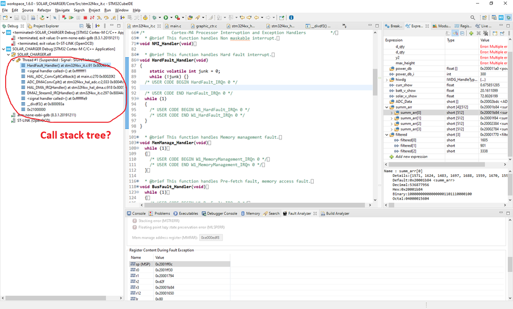

What ability to view the contents of the call stack in CubeIDE is present?, i.e. what functions were called before the crash, preferably in the form of a tree

thanks, i know this method but there is no call tree or stack info
2021-11-12 12:38 AM
what is it supposed to give?
2021-11-12 12:43 AM
I think this is call stack tree))
2021-11-12 12:49 AM
Yes, you're right.
2021-11-12 12:54 AM
If the debugger sits in the while loop, you can set the value of junk to 1 manually and continue stepping out of the handler and back to the code that caused it.
2021-11-12 1:10 AM
Smart solution, will try)
