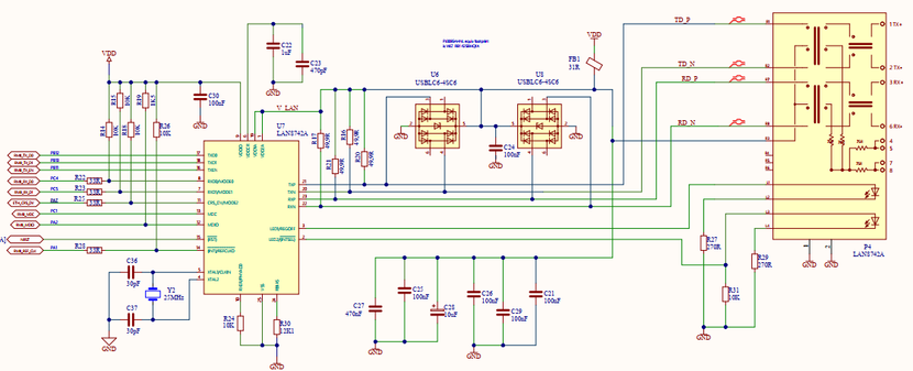

Could anyone help with this problem? Its driving me mad!!!
I have designed an ethernet interface for an F746-100 MCU
I have changed pins to avoid using Port G and I have used the circuit below.
The RJ45 connector is a standard RB1-125BAG1A and the ethernet chip is a LAN8742A
Can anyone tell me if there are any mistakes in this?
I cannot get any connection at all - F746-100 will not ping.
Green LED ON and Yellow LED flashes continuously.
I have an STM32F746 - 144 Nucleo with the same software (apart from the two pins that are changed) -works fine.
The 25MHz xtal works OK (same signal on both boards) and the LAN8742_STATUS_OK returns 0 on both boards when I debug.
There appears to be no errors in the setup LAN8742.c or the ethernetif.c when I debug. This code works OK on the NUCLEO board and I can display a small webpage. Both sets of code use only ETH and LWIP, fixed IP, on a standard Cubeide setup. I assume that the only difference is the two GPIO allocations (PG13>PB12 and PG11>PB11) which I have altered in software.
I have the same sort of signals on both boards on TXP/TXN/RXP/RXN
Can some kind soul tell me if there is anything obviously wrong with my hardware?
Thanks.
Chris

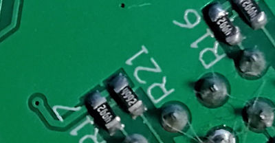

2024-02-01 6:55 AM
JOY of JOYS!!!
A *** mistake -
4 resistors on Ethernet circuitry were incorrect.
I am not too familiar with SMD markings, and I wrongly assumed '4992' was 49.9 ohms, when in fact they are 49.9Kohms.
It was not possible to measure them on the board since they were across a coil.
I replaced them with 4 standard resistors and ethernet works OK!
Thank you all so much for helping me.
The circuit and the project I uploaded are guaranteed to work, so hopefully this will help others.
Chris

2024-01-30 12:31 AM
Thanks STea/Stone-32,
I have placed (I hope) a better image of my circuit. Any suggestions would be helpful!
I have a feeling that this is the source of all my problems, although I dont know enough about LWIP and ETH to be certain.
I cannot find any similar project using STM32F746-100. It would be helpful if I could.

2024-01-30 12:48 AM
25.1 MHz - that on the board that is not working?
50 MHz clock is generated by the PHY?
After your GPIO switch - checked all the alternate function numbers?
PCB layout: around the crystal and clocks all clean? No crazy routing of the high speed signals?
PHY: Read all the registers and check / compare to datasheet.
2024-01-30 2:35 AM
Possibly slightly better image?
