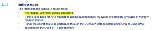

For the QUADSPI interface, in memory-mapped mode, the external flash memory is seen as an internal memory but with some latency during accesses. Only read operations are allowed to the external flash memory in this mode. as mentioned in RM0433 section 23.3.12 QUADSPI use.
The indirect mode mode support read and write operations.
For more information I advise you to take a look at Quad-SPI interface on STM32 microcontrollers and microprocessors - Application note
For the QUADSPI interface, the write operation is not supported in memory mapped mode.
For the OCTOSPI interface the write operation is supported in memory mapped mode as mentioned in Getting started with Octo-SPI, Hexadeca-SPI, and XSPI Interface on STM32 MCUs - Application note
The QSPI examples can help you to write and read data from external memory.
