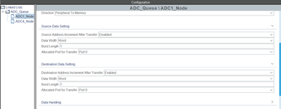

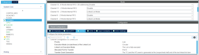

I have been trying for some days to read the values incoming form both ADCs, ADC1 & ADC4, from the NUCLEO U545-REQ.
The overall idea is to trigger both ADCs at the same time in output compare mode but if i try to trigger both of them at the same time in the live expression the read values are 0. I have tried to trigger the ADC4 in this mode and it works as expected.
I do not know the error i have. Find attached the configurations of the peripherals and the code:

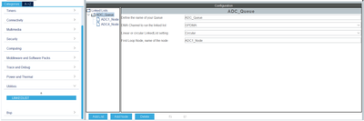

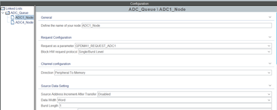

I have the Linked List configured as follows:
- Channel to run the linked list is GPDMA in circular mode and the first loop node is ADC1_Node.
- Two nodes are configured, ADC1_Node and ADC4_Node both with request parameter GPDMA1_REQUEST_ADC1 & GPDMA1_REQUEST_ADC4, direction is peripheral to memory in both nodes, data width is a word.

Heres the configuration of the GPDMA channels:
And heres the configuration of the ADC_Queue:
And the ADC_Nodes1(the ADC_Node4 is configured in the same way):
Is everything well configured?
