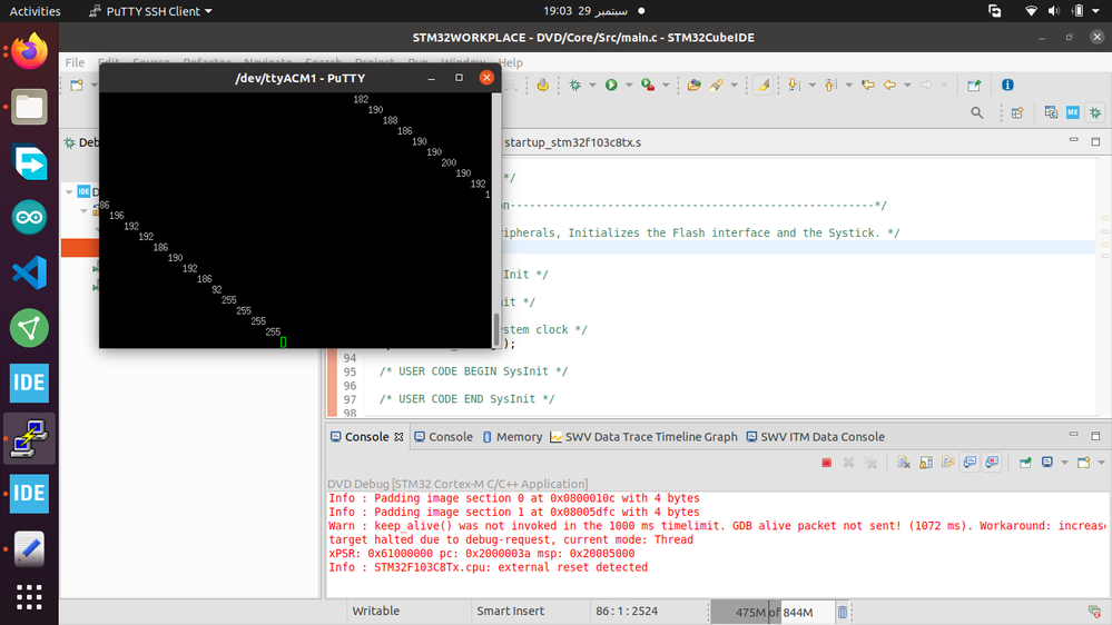

This has been a reoccurring issue for me, whenever I raise the ADC frequency above 0.25MHZ the while loop gets interrupted, and when I use frequencies below that the ADC resolution drops to 8 bits for an unknown reason. Is there a way to fix this without having to use poll for conversion or IT?
note: I'm using cubeIDE.

2021-09-29 12:09 PM
Also , how come the ADC resolution drops to 8 bits?

2021-09-29 12:30 PM
How do I increase the number of samples per interrupt? Also UART doesn't really matter for my project it's just to show that the resolution drops.

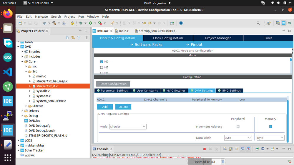

2021-09-29 2:10 PM
as it turns out, I set the data length to byte instead of word which is why i was getting small values.
