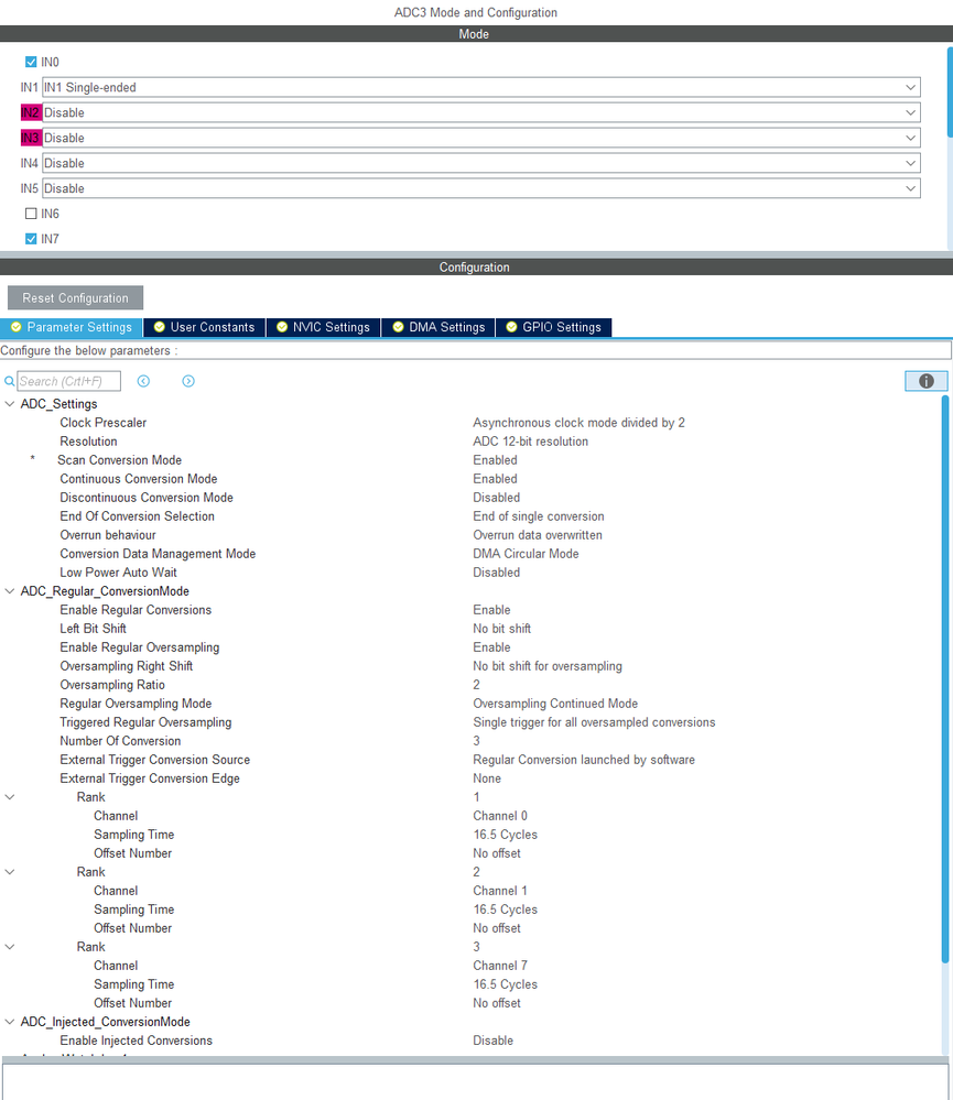

I am trying to read 3 ADCs channels using scan continuous mode and DMA with a STM32H7 (ADC3). Below the CubeMx settings + DMA.
In the main, before the While(1) loop I start the ADC with:
HAL_ADC_Start_DMA(&hadc3, (uint32_t*)adc_data, 3) ;
Where ADC_Values is uint32_t adc_data[3];
When I run the debugger, adc_data is always 0x0000.
Any hint?
Thanks

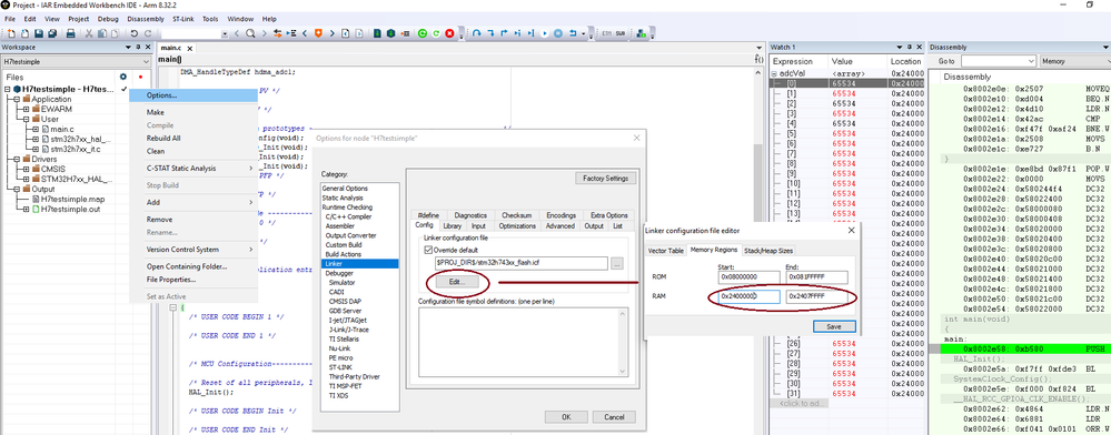

2020-02-11 8:21 PM
Are you handling the buffer coherency issue for ADC DMA read buffer correctly?
https://community.st.com/s/article/FAQ-DMA-is-not-working-on-STM32H7-devices
2020-02-12 2:19 AM
Hello @Yoichi Shinoda , thank you for your answer. I came accross that article and I think that's the issue I have. I tried to follow it but I think my knowledge about STM32 MCUs is too limited to really understand it ..
2020-02-27 2:33 AM
You should change the memory address, as shown in Figure (when using IAR)
Please find attached the RM0433 Rev 6 (page 101, 128) link for more clarification
Regards
2020-03-10 5:58 AM
Hi all,
User have to do this update
define symbol __ICFEDIT_region_RAM_start__ = 0x24000000;
define symbol __ICFEDIT_region_RAM_end__ = 0x2407FFFF;
manually (in the stm32h743xx_flash.icf ) since linker file is not managed by STM32CubeMX (copied from the FW package).
Best regards,
Nesrine

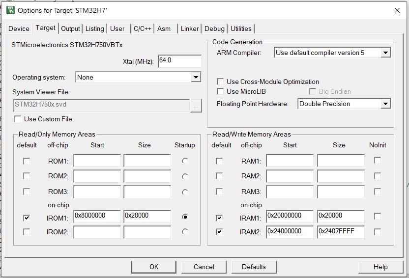

2020-04-03 12:20 AM
Dear @Nesrine.JLASSI , is this equivalent to setting the IRAM2 region in the target option in Keil ?
2020-04-03 7:05 AM

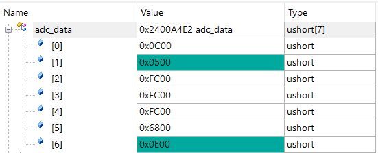

Hello @Nesrine.JLASSI and @Imen GH , modifying the IRAM2 in Keil did the trick. Now I can see the data being acquired by the MCU. However, I noticed that despite the ADC resolution is set to 16bits, I can only read 8bits since the the 8 LSBs are always 0, as shown in the debugger view below:
where :
uint16_t adc_data[7];
HAL_ADC_Start_DMA(&hadc1, (uint32_t*)adc_data, 7) ;
ADC initialization code:

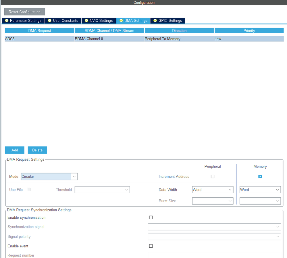

2022-02-28 3:21 AM
Hi @Mdi c , have you finally solved this issue? In my case, the DMA can only transfer the first byte correctly and leaves the remaining terms to 0.
Thanks
2022-07-24 4:47 AM
did you forget to change the DMA from byte to word?
