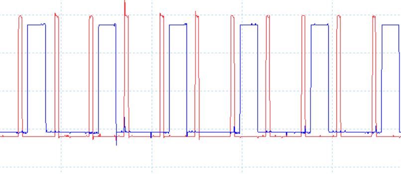

What I want to do: I want to start the conversion of 4 channels(scan conversion) when the timer 3 is in the middle of the PWM pulse.

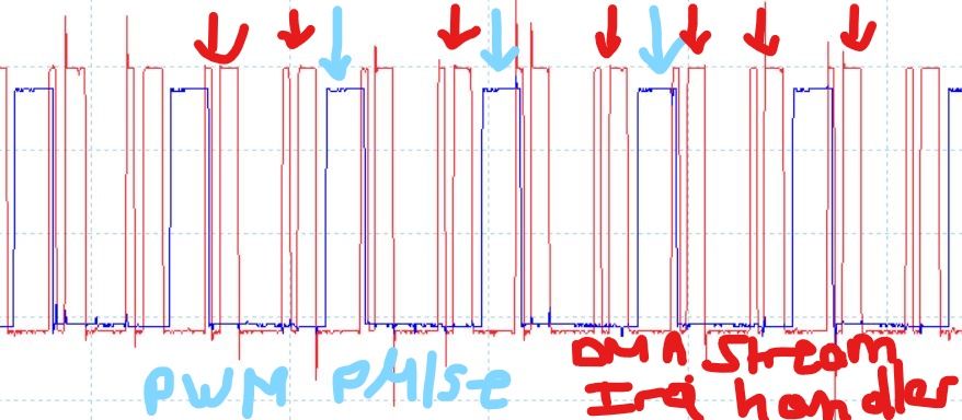

My problem: Actually my conversion seems well started on rising edge but also on falling edge.
I join screenshots of the oscilloscope illustrating the problem.
In blue it is the PWM signal.
In red is the time spent in the DMA2_Stream0_IRQhandler () function.
I do not understand two things about this capture: Why I do not fit in the DMA2_Stream0_IRQhandler () function in the middle of the high level and the low level because I am in the center aligned mode and that normally the UEV (update event) should be done
between.
Second remark it seems that the conversion is done on high level and on low level while I set externa trigger conversion conversion edge only on rising on rising edge ....

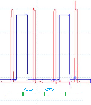

Here's another screenshot that shows the PWM signal and the time spent in the HAL_ADC_ConvCpltCallback () function.
Again we see that the conversions are on a rising and falling front.
I think I have to make a mistake in configuring my DMA ....

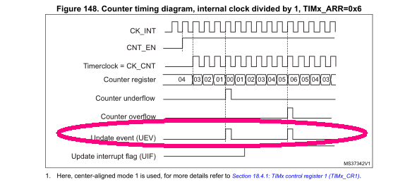

It may perhaps confuse you that there are 2 conversions per PWM cycle - but then there are also 2 Update events you are using as TRGO->ADC conversion start per period, in the up-down (a.k.a. center-aligned) mode:

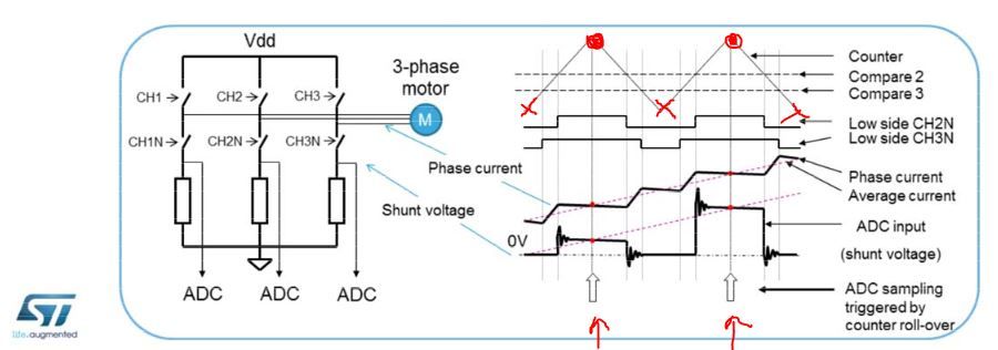

What I actually want to do is neither more nor less than what is described in the following picture :
I want to run a conversion cycle only in the middle of the high time of the PWM.
I understand that using UEV there are two events generated per PWM period.
Only I thought I would filter the first UEV using hadc1.Init.ExternalTrigConvEdge = ADC_EXTERNALTRIGCONVEDGE_RISING; but maybe I don't understand the TRIGCONVEDGE_RISING option.
Is there a better configuration to make this ?

I think Jan is correct. The Update Events occur at the center of the pwm Pulse (overflow event) and the center of the gaps (underflow event). Using your second scope trace....
The update events (green) are positioned as above.
Your 4 conversions take place over the intervals shown by the blue arrows, then followed by your EOC callbacks (red).
Do a test, shorten your adc conversion cycles to the minimum. The callbacks that currently look symmetric around the pwm pulse, will probably shift (not symmetric). The red pulse leading the pwm pulse will shift more to the center of the gap, and the lagging red pulse will shift to the center of the pulse. If shortened, your may finish inside the pwm pulse as you want.
Basically your sampling twice, once in the gap, and a second time starting at the pulse center, but the conversion don't finish inside the pwm pulse!
As Jan suggested, using the compare events, the events occur on the rising edge and following edges of the pwm. Rising compare will get you sampling in the pulse, but not centered on the pulse.
