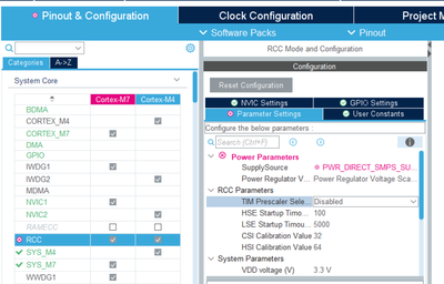

I noticed that the STM32CubeMX shows an error in the RCC configuration. So, please check the parameter settings?
Thank you.

@KDJEM.1 Thanks for an answer!
The CubeMX configuration is not relevant, because it's a pain to regenerate code each time after some field changed. And this particular error is a known bug of CubeMX: it doesn't allow to select PWR_DIRECT_SMPS_SUPPLY although it is used in original examples and works fine @480MHz.
2025-02-18 12:28 AM
