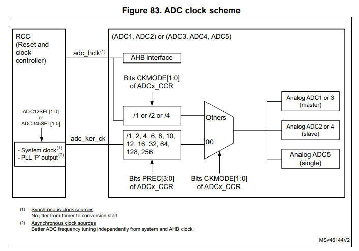

Documentation say ADC have max 4Msps, but it refer olways to 60MHz to adc (60MHz * 15 cycle = 4Msps) but manual say ADC max frequency is 170MHz, then 170MHz * 15cycle = 11Msps.
This clock is different from Fadc (aka adc kernel clock)?
Documentation 7.2.11 ADC clock

Read RM0440 21.4.3 ADC clocks but the interface clock and the clock used for the ADC.
170 MHz is only the interface clock!

then what is source of adc kernel clock? and what prescaler register it or have some default prescaler (and adc kernel clock is depend on sysclock?)?

I read RM0440 21.4.3 and I know AHB bus could have different clock that ADC clock, but still 7.2.11 say about ADC clk not AHB bus.
"Alternatively, the ADC clock can be derived from the AHB clock of the ADC bus interface", then it could have same clock that interface?

if PLL 'P" and SYSCLK is only for source interface clock, then where is source clock for ADC conversion?!

You're expected to select a clock and prescalers to have the clock at the mux to be 60 MHz or less.
