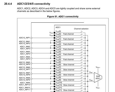

I would like to check if it is possible to have this config:
- ADC1 IN3 and IN4 as differential input (signal A)
- ADC2 IN4 as single ended input (signal B)
Then perform adc conversions in dual (interleaved) mode and get close to 4msps for signal A as well signal B. My concern is that IN4 is used on both peripherals, not sure if this is a problem, if I read the reference manual, it should not be a problem as long as they are not sampled at the same moment, therefore you need interleaved dual mode if I'm correct.

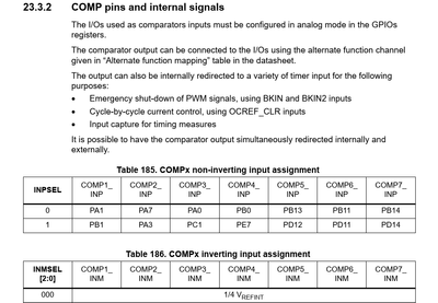

Furthermore I would like to know if it's really possible to connect 3 peripherals to a single pin, like the PA0 pin:
- COMP1_INM
- COMP3_INP
- ADC1_IN1
If this is possible, are there any side effects that can occur?

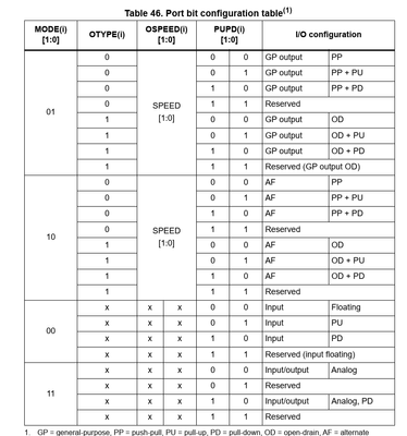

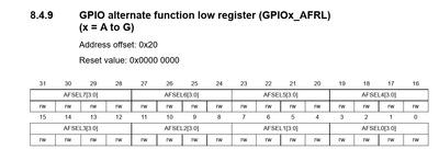

why (most times) its not a "problem" of Cube, not allowing multiple connections on one pin:
see rm, about gpio -> alternate functions :
So you can set just ONE alternate function to a pin .
Maybe your lucky : ADC might have its own (analog) input multiplexer, so connecting adc1x and adc2x to same pin is no problem, both are on same pin setting (-> analog).
But if they need/use different AFSEL numbers (multiplexer), then ...no. (Say , ADCin + TIM external count in )
Cube is just the fastest way, to see, whats possible. (But not always shows all possible combinations...)
So if you want to know for 100% sure, look in rm . (But most times Cube "is right" .) :)

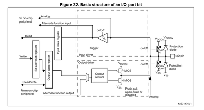

Sure. When ADC is sampling, it switches its input cap to the pin.
IF you have no low impedance driving the pin, it will give a small voltage "spike", that might switch the comparator...
So : side effects depend on your circuit.

2024-06-15 4:54 AM
Right !
Maybe you cannot do all together (interleaved and normal mode), then try:
standard sequence in interleaved mode and the "extra" ADC1 IN3 as injected sequence.
