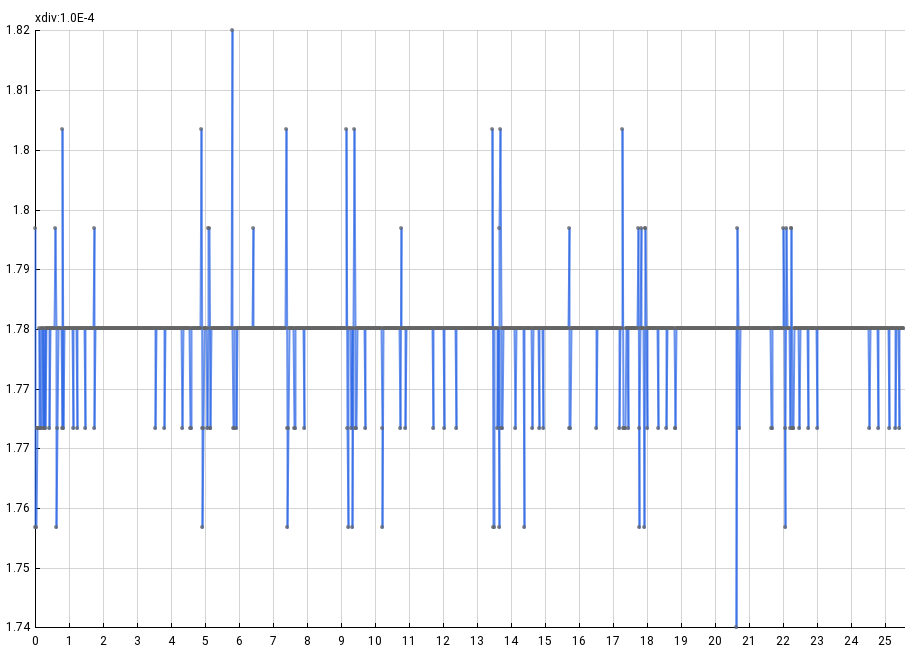

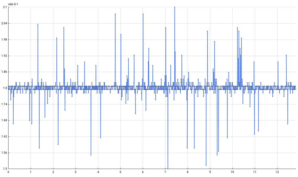

I've done a little different experiment, I turned the stm32f401 into a little 'oscilloscope', here is what is seen at PA0 ADC1, the temperature sensor LMT86 is connected there.
This is at 1 k samples per sec. scaled at 0.1 xdiv (so 10 is actually 1 second).
STM32F401 is running at 72 MHz, ADC clock = 72 / 2 = 36 MHz.
Sample time is 3 clocks for these charts.
The axis seemed to be obscured when zoomed in, it may be necessary to download and view it.
1.77-1-8V is the voltages from LMT86. What is more interesting are the spikes, they seemed rather irregular and quite large, the large ones seemed to be around 0.3 v.
It seemed there is no observable periodic A/C signals, as A/C signals are around 50/60 Hz, they should be rather visible if they are present.

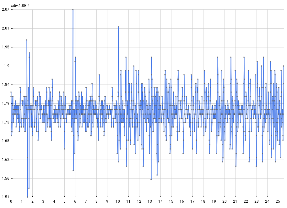

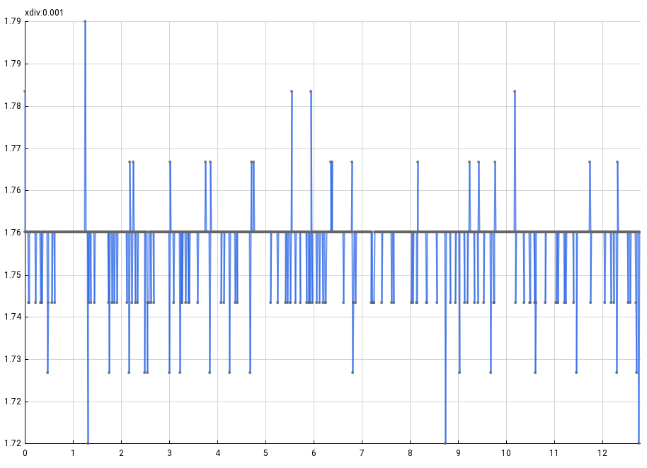

Another view at 10 kHz. xdiv is 0.01 so 10 on x-axis is 0.1 of a sec.
Another view at 100 kHz. xdiv is 0.001, so each unit is a millisecond
2021-09-21 12:25 PM

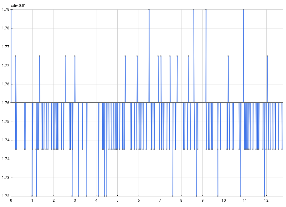

The above 'scope' charts seem to suggest why, apparently, that 'median' filtering seemed to work. The sensor voltages is concentrated in a narrow band.
I'd continue to work the tests to see if those (noise/spikes) could be identified to particular sources. Prior to this, as I used rather low sample rates, I'd guess it is a reason sometimes I do not encounter the spikes and the readings fall within range. But given the spikes, and a rather long sample time of 84 clocks, if a spike occur, it may change the sampled voltages in the ADC.
Note that the 220 uF capacitor is connected at 3.3v rail for these 'oscilloscope' charts.
It seemed this may be affected by impedance issues, 3 clocks at 36mhz is a pretty short sample time. And the LMT86 has a 50 uA max output.

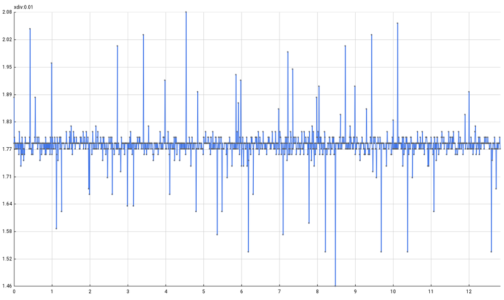

I placed that LMV358 in the path as a buffer, full negative feedback, so gain = 1. This should work like a low pass filter with cut-off at about 1 MHz (in spec). Then I do that ADC 'scope' again.

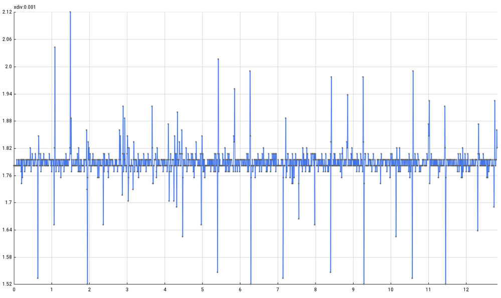

500 k samples per sec, I chanced upon this. It doesn't always look like this, it so happen to be one of a random capture. Note this is the output from the Op Amp with the sensor + cable as input.
More often it looks like this (300 k samples per sec)
I could nearly imagine, if I put a diode and a capacitor in the former, I'd probably hear some sounds. It seemed there is a possibility it is after all radio waves.
The 220 uF bypass cap is still connected at 3.3v to GND.

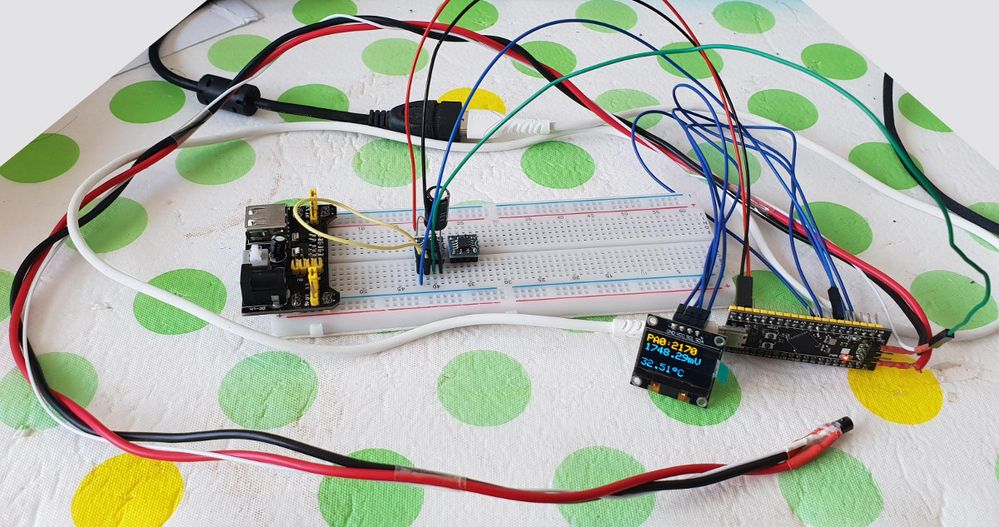

As I need to move away from my desk for a while, here is a snapshot of the contraption I've setup for the experiment.
The STM32F401CCU board and the SSD1306 is visible on the right. Those things on the breadboard are the LMV358 op amps (there are 2 sets of them, but only one of them is used currently). There is a capacitor overhanging that LMV358, that is the 220 uF capacitor connected across 3.3v power rail to ground.
3.3v Power is currently drawn from the LDO on the STM32F401CCU board, that is supplying all the components seen in the experiment.
This includes the stm32f401 MCU itself (its VREF+ goes to VDD, VREF- goes to GND as seen in a schematic for the board). This same 3.3v LDO on the board powers the
On the left of the breadboard is a breadboard power supply that can be powered from a 5v USB mobile charger, it has 5v - 3.3v LDO on board. In this experiment, that external power supply is currently unused.
The 'transistor' in the bottom right in the foreground is the LMT86 temperature sensor. I connect it to the ADC over long wires (the cord) as this is intended to be used as a probe to calibrate thermistors with unknown parameters.
My guess is with the long wires, I've accidentally made this an antenna and that LMT86 is a diode kind of, and with amplification internally. That may have accidentally turned this setup into a radio, a simple diode detector. And what is seen at the STM32 ADC may be the AM demodulated signals.
If this is true, it probably explains the large volatility, variance seen in what is assumed to be a static voltage from the 'temperature sensor'.

2021-09-22 12:20 PM

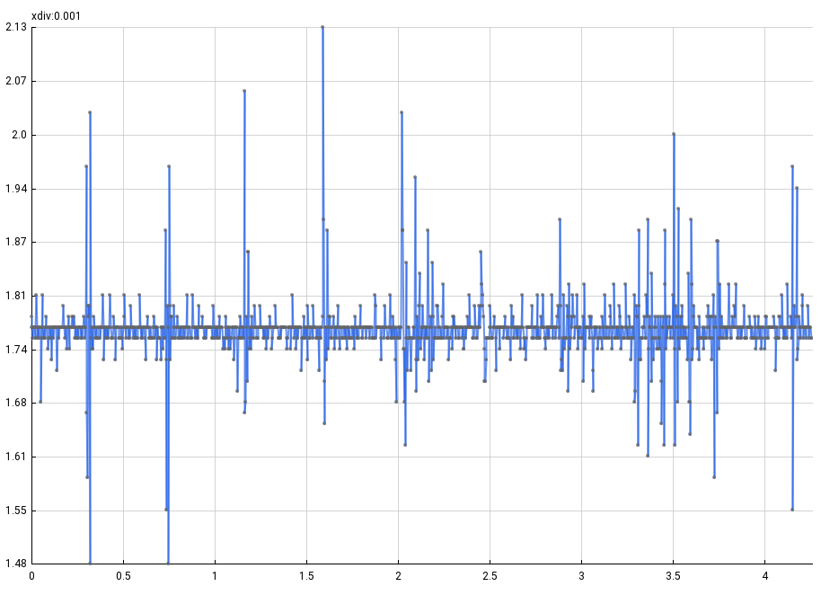

And one more round of checks on the 'scope' graphs. LMT86 patched directly on the breadboard - no long wires / no cords / no op amps etc.
10k samples per sec STM32F401 ADC PA0
100k samples per sec
500k samples per sec
There are still some visible artefacts, but that the amplitudes are much smaller.
This basically confirms the 'radio waves' interference hypothesis
