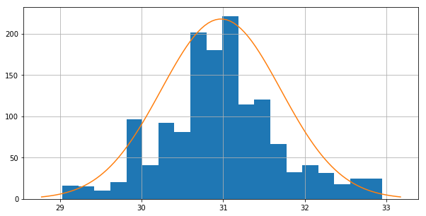

So next I strapped up an LMV358 Op-Amp as a buffer and here are the observations. This is with the Op-Amp
common parameters for charts below: adc clock 84 mhz / 4 ~ 21 mhz, 84 clocks sample time
2000 samples, 10 samples/s, measuring room temperature about 30.5-31 deg C
count 2000.000000
mean 30.882000
std 6.782125
min -213.360000
median 30.960000
max 57.800000
No, temperature did not accidentally drop to near absolute zero. It is room temperature all the while during measurement, a multimeter did not change a single millivolt while variances are recorded by the ADC.
Next, I set up a filter to remove all values outside +/- 2 deg C from the median, 555 outlier values removed.
count 1445.000000
mean 30.973156
std 0.733296
min 29.030000
median 30.890000
max 32.950000

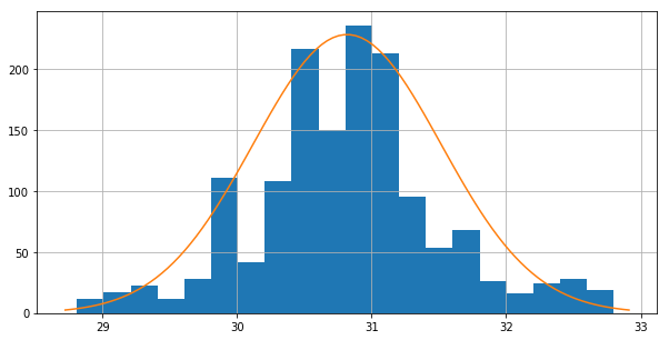

Next remove that Op Amp and connect the sensor LMT86 directly to the ADC (on stm32f401)
count 2000.000000
mean 30.930100
std 4.062343
min 3.670000
median 30.810000
max 59.260000
Next, I set up a filter to remove all values outside +/- 2 deg C from the median, 500 outlier values removed.
count 1500.000000
mean 30.817787
std 0.698166
min 28.810000
median 30.810000
max 32.800000
It is a dilemma kind of. The Op-Amp probably reduce the impedance (significantly?), but that the errors/variance are about the same !

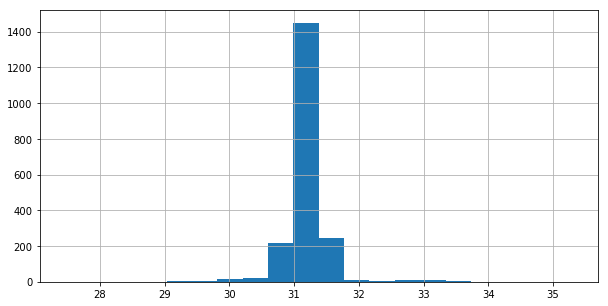

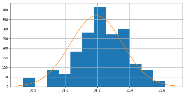

Here is an update, I patched a LMT86 directly on the breadboard - no long wires / no cords / no op amps etc.
2000 samples, LMT86 direct to STM32F401 ADC PA0
LMT86 direct to STM32F401 ADC PA0 discarding 122 values outside 0.5 deg C range from median, this is barely around 5% of 2000 samples.
count 1878.000000
mean 31.195000
std 0.162021
min 30.740000
25% 31.110000
median 31.180000
75% 31.330000
max 31.620000
This result is astonishing, standard deviation is 0.162 deg C. 95% confidence interval is 1.959 sigma ~ 0.31736.
Now LMT86 measured on stm32f401 ADC pa0 is +/- 0.31736 deg C accurate at 95% confidence interval.
Then taking the full 0.5 deg C interval, that is 3.08 sigma, that is > 99.8% (accurate) confidence interval
https://en.wikipedia.org/wiki/Normal_distribution#Quantile_function
LMT86 is an accurate device, and it meets the specs published by TI, when a near noiseless measurement on stm32f401 ADC is possible.
The histogram is showing bars for temperatures well within 0.1 of a degree C. And I'm using only 12 bins for 2000 samples.
Working this back to the specs for LMT86, it is -10.9 mV average gain per deg C.
This translates to a +/-3.46 mV accuracy measured on STM32F401 ADC at 95% confidence interval.
And at 0.5 deg C at 3.08 sigma (> 99.8% confidence interval) it is +/- 5.45 mV at pretty much > 99.8% confidence interval measured on stm32f401 ADC.
Measurements are still stochastic, as I can observe varying numbers with each sample. But the samples and mean conforms well to a bell curve (normal distribution), after dropping the *outliers*.
Still can't rule out radio interference etc as noise sources which probably cause the variations and especially the outliers.

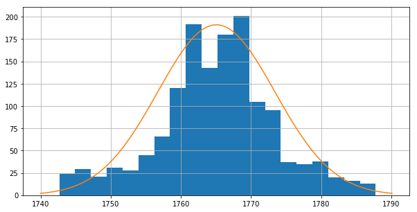

Here are the same charts in millivolts (that is derived from ADC value * 3.3 / 4096)
this is for LMT86 temperature sensor - LMV358 Op Amp - STM32F401 ADC pa0
count 2000.000000
mean 1765.447655
std 45.694276
min 1466.310000
median 1765.210000
max 2223.630000
removing 561 outliers outside 0.5 std from previous count 1439.000000
mean 1765.045448
std 8.352023
min 1742.650000
median 1765.210000
max 1787.770000

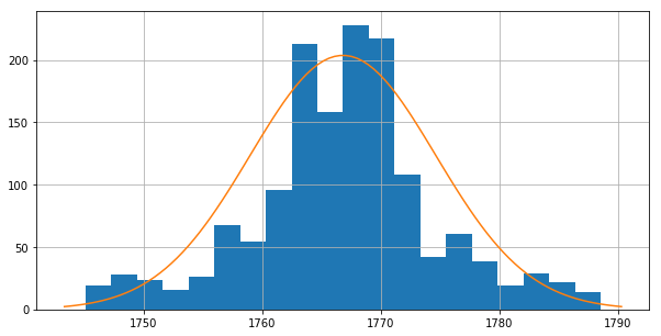

This is for LMT86 temperature sensor - STM32F401 ADC pa0 direct
count 2000.000000
mean 1766.020125
std 44.989596
min 1449.390000
median 1766.820000
max 2061.690000
removing 519 outliers outside 0.5 std from prior count 1481.000000
mean 1766.806712
std 7.830439
min 1745.070000
median 1766.820000
max 1788.570000
So it seemed the range of the outliers can be pretty large, they seem to be about 0.7-1V. That accounts for the extreme temperature readings.
As LMT86 has a spec of -10.9 mV / C, that kind of translate to a 64 deg C range for the volatility as seen in the ADC readings.
The unfiltered graphs are also noticeably not a normal distribution.

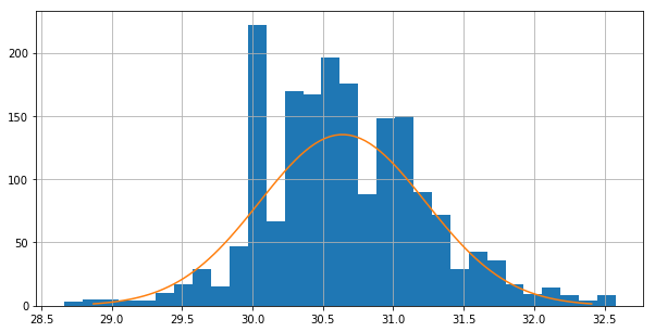

Some findings, adding a 220 uF capacitor at the 5v supply before the LDO (it is the usb from PC actually)
count 2000.000000
mean 30.809150
std 2.734337
min 5.710000
median 30.600000
max 54.450000
Next, I set up a filter to remove all values outside +/- 2 deg C from the median, 147 outlier values removed.
This is significantly less than previous
count 1853.000000
mean 30.639255
std 0.589653
min 28.660000
median 30.600000
max 32.580000
220 uF is a little extreme, but it did reduce the count of outliers outside +/- 2 deg C significantly
Unfortunately, the range of that outliers did not reduce significantly. It seemed there is a possibility the ADC is picking up signals from sources other than the sensor alone. Though at the pin, only the sensor is connected (across a wire to the probe).

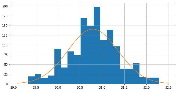

n = 2000, lmt86 direct
no fil
192.2082880456942 [0.575 0.655 0.785 0.916 1.09 ] [15. 10. 5. 2.5 1. ]
tol = 5 del 254
64.04789448918518 [0.575 0.655 0.785 0.916 1.09 ] [15. 10. 5. 2.5 1. ]
tol = 3 del 380
28.67826080132636 [0.575 0.654 0.785 0.916 1.089] [15. 10. 5. 2.5 1. ]
tol = 2 del 500
9.98471395356546 [0.574 0.654 0.785 0.916 1.089] [15. 10. 5. 2.5 1. ]
tol = 1.5 del 588
3.7181488303444894 [0.574 0.654 0.785 0.915 1.089] [15. 10. 5. 2.5 1. ]
count 1412.000000
mean 30.791516
std 0.567874
min 29.330000
median 30.810000
max 32.290000
tol = 1 del 705
4.255539391071579 [0.574 0.654 0.785 0.915 1.089] [15. 10. 5. 2.5 1. ]
tol = 0.5 del 1203
9.760407662442503 [0.573 0.653 0.783 0.914 1.087] [15. 10. 5. 2.5 1. ]

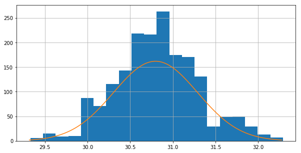

This result is important. The Anderson-Darling statistics started high and reduce to the smallest after values outside +/- 1.5 deg C from the median are removed. Below that, the statistic increase again showing a poorer fit. So +/- 1.5 deg C is the best fit. This is based on 2000 samples and a static (room) temperature.
After removing outliers beyond 1.5 deg C,
with the 220 uF cap at 5v, standard deviation is 0.540934, 184 values removed
with the Op-Amp (no cap), standard deviation is 0.605743, 643 values removed
LMT86 direct (no cap, no Op-Amp) standard deviation is 0.567874 588, values removed
The graphs is like such:
95% confidence interval is about 1.96, so that gives an accuracy of +/- 1.11 deg C at 95% confidence interval measured at the ADC !
If we simply take the +/- 1.5 deg C range, that is 2.64 sigma, this is pretty much 99% confidence interval
Then we go back to the specs for LMT86 , which provides -10.9 mV/C.
This means the stm32f401 ADC under test has an accuracy of about +/- 12 mV at 95% confidence interval and +/- 16 mV at 99% confidence interval ;)
But these results are very stochastic, it takes lots of measurements and requires a static value to achieve such accuracy.

OK here is it 220 uF on 3.3v after LDO, LMT86 direct to STM32F401 ADC pa0, no Op Amp, 2000 samples, 10 samples per sec, 84 cycle sample time as is previous
count 2000.000000
mean 30.730650
std 7.015711
min -176.190000
median 30.810000
max 56.960000
The above data after removing 193 values > 1.5 deg C from the median:
LMT86 to STM32F401 ADC, 220 uF on 3.3v
removed 193 values > +/- 1.5 deg C from median
count 1807.000000
mean 30.796469
std 0.492922
min 29.330000
median 30.810000
max 32.290000
The count of outliers outside 1.5 deg C from median is comparable to that if 220 uF is placed before LDO at the 5v rail. 'Wild' outliers still occurs, there is one at -176 deg C (that one has a reading about 2.124 V), temperature measured is room temperature, values closer to room temperature 30 deg C is about 1.776 V. (edit: there is a bug for this value kind of 2.2v should be about 0 deg C as that's the spec for LMT86, Newton's method isn't a most stable solution search algorithm. But that this is still pretty much an outlier. 2.124 - 1.776 = 0.348 v, so using 10.9mV/C as an estimate that makes for a 31.9 deg C difference)
Oh, but the standard deviation after removing the outliers is the smallest so far at 0.49, so 95% confidence interval is +/- 0.96 deg C. at 1.5 deg C based on the filter, that is > 99% confidence interval at > 3 sigma.
It'd take a while to figure out where else are the noise sources, I'd guess. One of those tests I intend to do is to run it on batteries, that would take some work. Currently, it is pushing the values over usb-serial connection to the pc.
