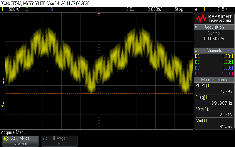

I am working with STM32F429Zi microcontroller on a customized board. I am acquiring the signal shown below (oscilloscope screenshot) with ADC3 at a sampling rate of 300ksps. The input signal is a 10kHz sinusoidal waveform superimposed on a 100Hz triangular waveform.

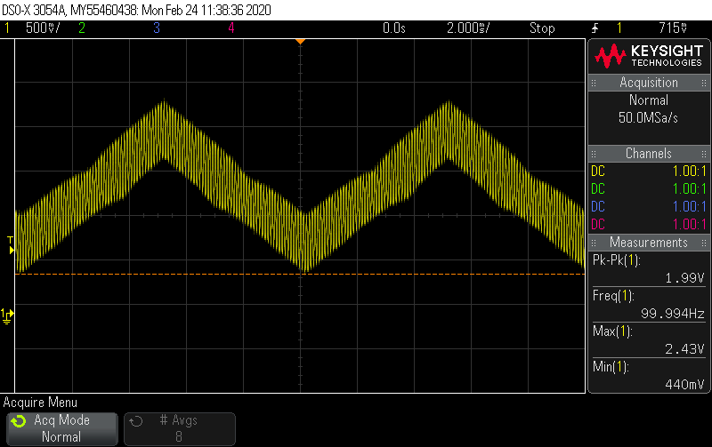

The signal contains a lot of high frequency noise and I am only interested in a frequency content of less <=10kHz. So I made a 1st order passive RC low pass filter (cut off frequency 172kHz). The output of the filter as seen on Oscilloscope is shown below.
I am using 2nF and 1.2 kohms for the low pass RC filter. These values have been calculated considering the minimum RC value needed to settle the ADC input while also band limiting the noise. This is calculated as explained in the Analog Dialouge article “ Front-End Amplifier and RC filter design for a precision SAR Analog-to-Digital Converter�? by Alan Walsh. For 100ksps sampling rate these values were 2nF and 470ohms.

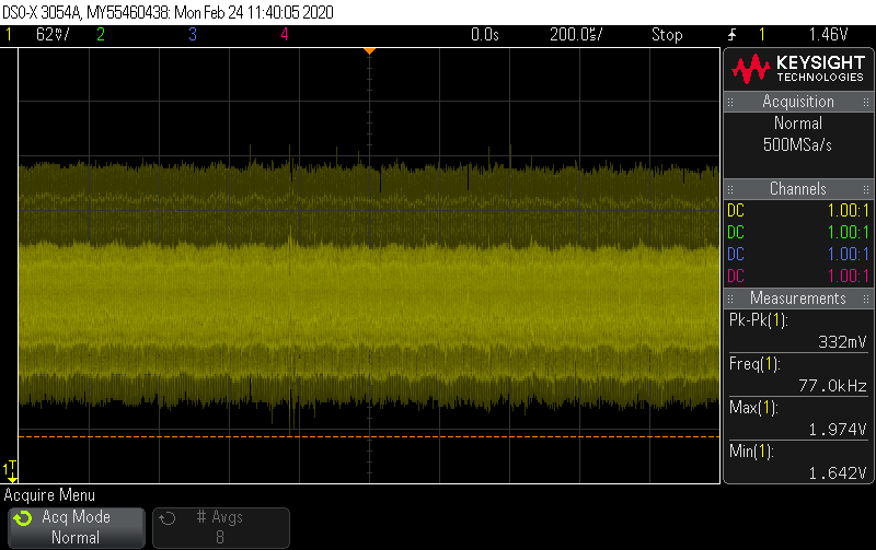

However, as soon as I connect this filter output to ADC3 input I observe that the signal amplitude is completely lost (shown below).

The last image looks like the scope had no periodic trigger.
Adding a passive RC filter will increase the input impedance, and might "break" the sampling.
Consider a buffer amplifier, or, perhaps better, an active lowpass filter.

Remember that the STM32 ADC input is switching capacitors. If the ADC input only sees the 2 nF, sampling problems arise. Put an active buffer after your filter.
