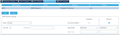

Sorry i forgot to mention that i already configured circular mode and increment memory address, here i provide a screenshot in case I'm not doing it right. I used Half Word length because i use 12bit ADC mode.

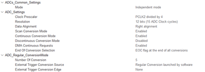

I also have my ADCs Global Interrupt set to Enabled, although it doesn't do much when I change the ADC Global Interrupt setting.
Here are my ADC Parameter settings
Anyway, i tried setting the ADC's EOC as you suggested but the result remains the same...I also tried changing the code so the array get transmitted regardless of the adc_conv_complete_flag condition, to no success either.
