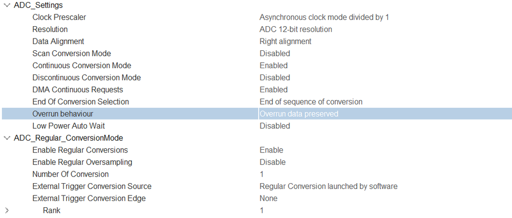

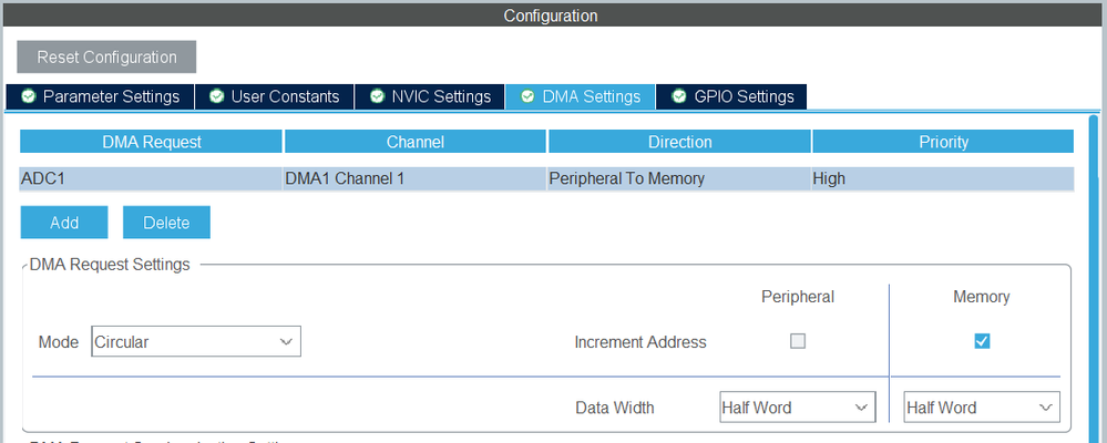

I am trying to use a circular DMA to transfer ADC samples on STM32L4R9VI.
I configured a 3.2 Msps sampling frequency, which means that HAL_ADC_ConvCpltCallback and HAL_ADC_ConvHalfCpltCallback must be called each 10 ms for a 64000 elemets buffer.
However, i measured the interval between each callback and it gave 10 us ...
The following screenshorts are for DMA and ADC config
2021-06-10 7:21 AM
Show the code that actually sets up and starts the conversion.
