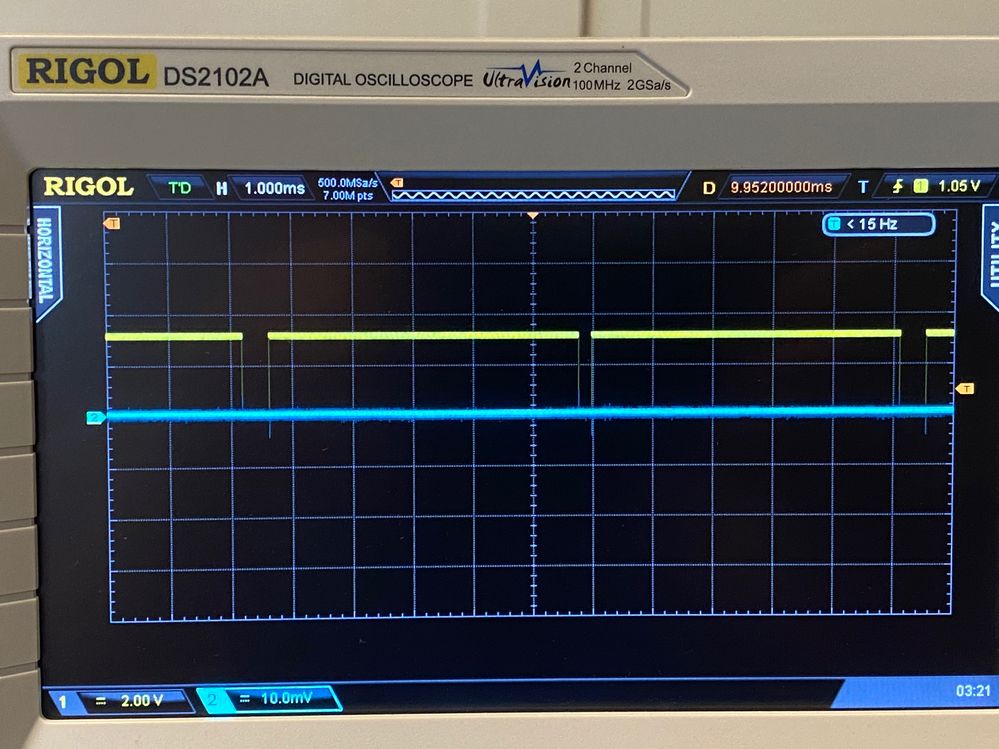

The issue started when I began porting this code over to the STM32F334C8T6. I got everything working great until I started on the DAC and DMA. The initial problem was that HAL_DAC_ConvCpltCallbackCh1 was never called. HalfCplt was called, but it was executing slowly, and completely blocking all other code. Here is a scope shot of PA7 (you can see it set and reset in the callbacks in the code snippet)
I tried checking the flags in the DMA1_Channel3 IRQ handler and indeed, I always had TC, HT, and GL flags set for both DMA1_Channel3 and DMA1_Channel1 (set up for the ADC transfer). I'm not sure what to make of this.

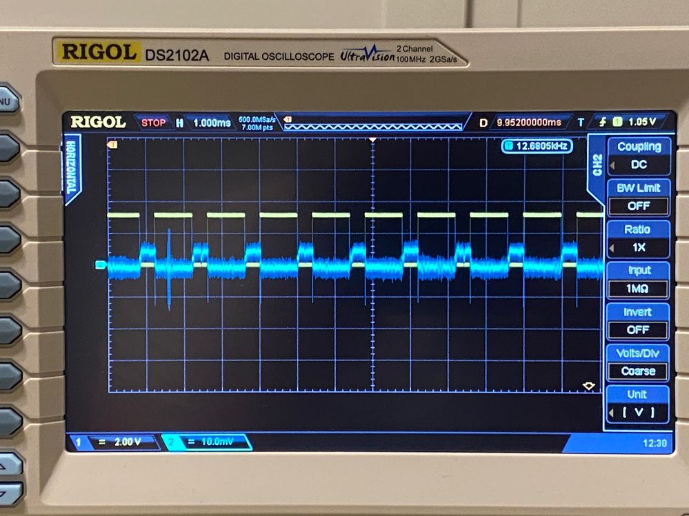

Then, sort of as a fluke, I tried uploading the working code from my STM32F334K8 project and the audio started working! Both ConvCplt and HalfCplt get called, at the right rate. But, some mysterious GPIO related bugs appeared too, and I noticed eventually that there was some gnarly noise in the DAC output signal, correlated with the DMA activity...
I went on to copy every .c, .cpp, and .h file between the two projects to make them identical, found that they compile to two different sizes (~17k for the K6, ~19k for the C8) and still exhibit the differences in behavior. Unfortunately, neither is currently usable, as I either have inconsistent GPIO behavior, or only half of my DMA callbacks happening. I know there are a ton of question marks here for someone reading this post, but does anyone have any insight at all into what might be happening? I was not able to find any reason for the two file sizes to be different, nor actually any setting or code that would distinguish the two targets!
