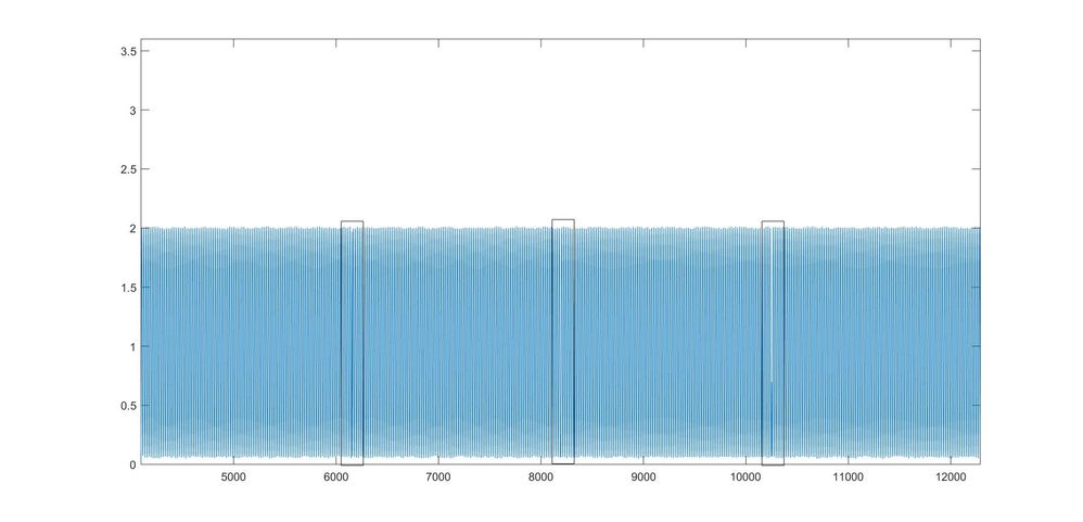

Thank you for your help. DMA was already configured in circular mode and even if it is better than before, when I store at half-complete and transfer-complete interrupts I still lose datas when I change the buffer (in the black rectangles on the photo).

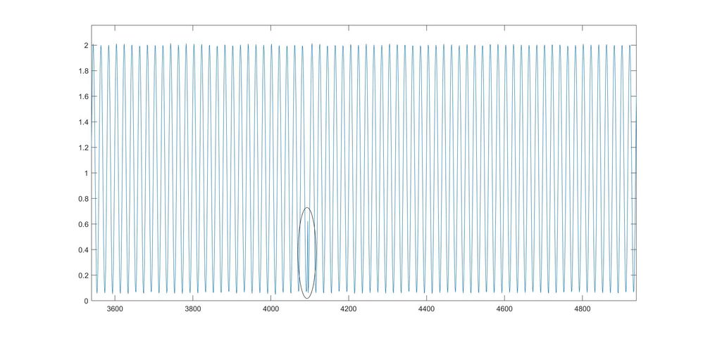

This seems to be better, but I still have some losses like on the photo. I am wondering if it could come from the writing speed of my SD card which is to slow. More I don't use 4 bit mode for SDMMC1 because I always have Rx overrun error :grinning_face_with_sweat:.
***EDIT***
The "losses" seem to come from ADC because I have "glitches" like in the photo even in the middle of the half part of the buffer for exemple.
Thanks for your help :D
