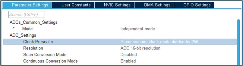

The first thing I noticed that the ADC Clock Prescaler setting seems to be no longer a thing.The last time I set it up, I just chose continuous conversion with a prescaler and everything worked. Even without an timer. These were my settings back then:
Note here that it is the same MCU on the same board in the same project. I only updated the cubeIDE.

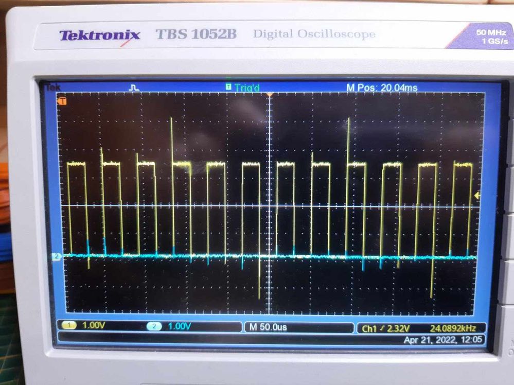

I now tried it with a timer (which is preferred anyway) but this still doesn't work. The timer works as can be seen on the oscilloscope here:
The yellow line is the timer, the blue line should have a peak triggered in the convCplt interrupt. DMA is set up with a circular buffer.

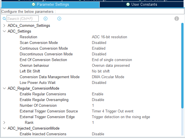

Here is the setup:
I'd really appreciate any input on this because at this point I'm not sure if I'm doing something wrong, or if there is a bug in the cubeIDE.
