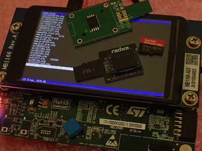

I also have Radxa eMMC to uSD converter with Chinese 64GB eMMCv5.1(Look attached picture).

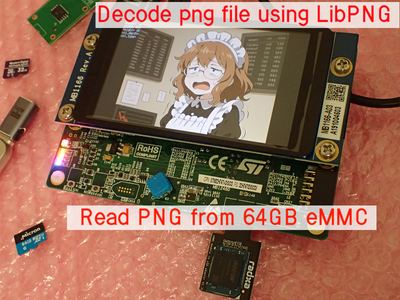

I've implemented eMMC & integrated with SDcards handlings to STM32H747I-Disco with FatFs.
Here is my GCC project(notice: NO-CUBEIDE and NO-CUBEMX,makefile build only).
https://nemuisan.blog.bai.ne.jp/?eid=192848#STM32H7
SDMMC with IDMA for FatFS implementaion(may be what you want)is found my project directory inside.
./lib/ff/sdmmc_stm32h7.c
./lib/ff/sdmmc_stm32h7.h
It is not so difficult to migrate other STM32H7,enjoy STM!
