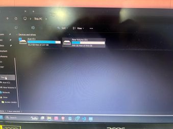

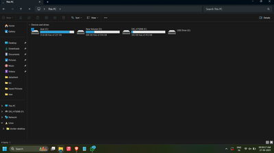

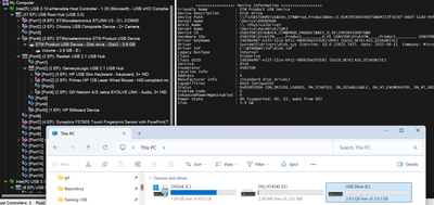

2025-06-26 9:29 PM - edited 2025-06-29 10:34 PM
UPDATE:
the PC detects eMMC sometimes and sometimes it doesn't when i plug it into PC. Also i am not able to format this disk too. it gets disconnected after sometime.
