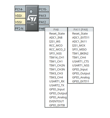

  2. In STM32CubeMX, I don’t see any option to configure I2C on those pins for the SO8N package — is this a limitation, or is there a specific way to enable this functionality?
  3. How should I properly interpret the [PA9] notation next to PA11 in this context? Is it automatic remapping, or something that must be configured?

That said, I’d like to be 100% certain about this specific behavior before relying on it in my design, especially since CubeMX doesn’t show I2C as an option on pin 5 (PA9) in this package. If anyone has official confirmation from ST or has tested this exact configuration (e.g., using PA11 as a remapped PA9 for I2C or USART in SO8N), I’d really appreciate the reassurance.
Just want to be sure I’m not misinterpreting the datasheet or overlooking any limitations.

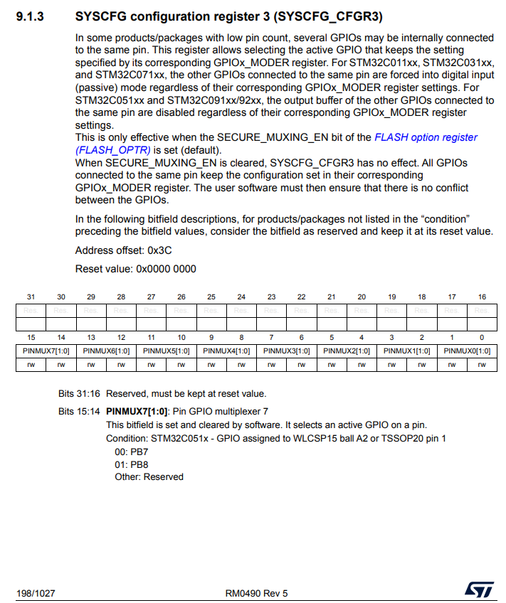

It seems there is a multiplexer ("PINMUX") to decide which GPIO is routed to the physical pin:
https://www.st.com/resource/en/reference_manual/rm0490-stm32c0-series-advanced-armbased-32bit-mcus-stmicroelectronics.pdf#page=198
via: https://www.st.com/en/microcontrollers-microprocessors/stm32c011d6.html#documentation
Dear Duo,
STM32C011xx(SO8 Package) needs remap to use I2C peripheral;
Here is a piece of my example code.
#if defined(USE_STM32C011X_DK)
	/* Remap I/O for STM32C011xx */
	/* Enable SYSCFG */
	__HAL_RCC_SYSCFG_CLK_ENABLE();
	/* Remap PA11,PA12,PC14(1-wire) I/O for SO8 Device */
	if((DEVID_REG == 0x443UL) && (PKG_REG == 0x0001UL)){
		SYSCFG->CFGR3 |= SYSCFG_CFGR3_PINMUX0_0 | \
						 SYSCFG_CFGR3_PINMUX2_0 | \
						 SYSCFG_CFGR3_PINMUX4_0;
	/* Remap I2C1 I/O PA12->PA10,PA11->PA9 */
	HAL_SYSCFG_EnableRemap(SYSCFG_REMAP_PA12 | SYSCFG_REMAP_PA11);
#endif
Entire GCC project is below URL(notice: NO-CUBEIDE/NO-CUBEMX, makefile build only).
https://nemuisan.blog.bai.ne.jp/?eid=192848#STM32C0
