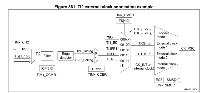

Yes - but still some delay... -> see Tim input circuit:
+ the inputs need to be sync to internal clock , so they go to one or two flip-flops first, to be sync .
All this running on the timer clock...so at first: higher clock -> less "delay" (for symc circuit).
Then Filter : off. (delay much more, depending on setting).
Then...maybe shortest, you can get this way.
+ Some "sync circuit" you have on all inputs, that come to the internal circuits, to avoid race conditions.
If you need the pulse without any delay, use a simple external gate; maybe controlled by a cpu pin, to en-/disable it.

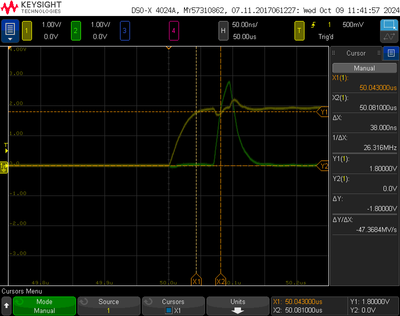

Thank you for the reply. I do have filter off, and I could potentially run the CM4 at 240MHz, hopefully yielding ~20% improvement. The delay is still larger than I would have expected.
We're considering an external pulse generator instead of having the H7 do this. I was hoping the H7 would be up to the task, especially because all the pulse generator ICs I've used in the past seem to be going obsolete, such as: https://pdfserv.maximintegrated.com/en/ds/DS1040.pdf . Might have to consider an FPGA for this signal conditioning?
I updated the pin output speeds and might have improved it to ~40ns delay, but that might be the best I can do. Though putting on the scope, on this STM32H757i-eval board I've got some slow rise time on the TIM1 yellow PWM output and voltage drop when I connect TIM1 PWM output to TIM8 TI1FP1.

>on the scope
is a DSOX4024A - right ? So you have probes at 10:1 ? and hi-speed probes ? adjusted/calibrated?
because getting about 30ns rise rime is way too slow , for this scope.
Pin output speed H7 at very hi ? (is about 1ns rise time then...so something wrong on your measurement.)
And clock for tim1 is high ? (at 120MHz , APB timer clocks , i think. Makes about 16ns for two FF to set.)

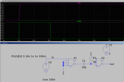

>consider an FPGA
Come on - an FPGA for one pulse ?
Just 2 UHC nand gates...
...and you have the 20ns pulse, at about 3ns delay; first gate v+ is control: enable or disable (lo) the pulse.
gates:
https://www.mouser.de/ProductDetail/onsemi-Fairchild/NC7WZ38K8X?qs=jumAldekxNB%252BQGRGFjackg%3D%3D
or mini..
(i like this series...)

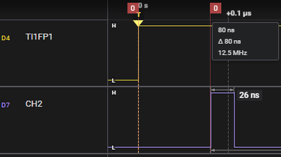

2024-10-09 9:28 PM
Tested on my nucleo-H743zi2, get 27 nanoseconds delay. uCPU running at 480 MHz.
Reference manual suggest to set TIM_SLAVEMODE_COMBINED_RESETTRIGGER, but I see no difference with
TIM_SLAVEMODE_TRIGGER.
I also checked bits:
00100: TI1 Edge Detector (TI1F_ED) -> dual edge, same delay
00101: Filtered Timer Input 1 (TI1FP1) <- C6
00111: External Trigger input (ETRF) <- A0
to verify if filter logic introduces any additional clock in pipe line, but non. Same delay with ETRF pin.

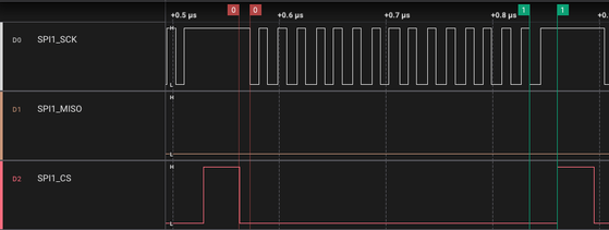

This entire exercise started because once turned on and free running, the STM32 SPI peripheral HW timing at 100MHz does satisfy the requirements of a chip we are using.
The tdcnvsckl at 100MHZ is ~ 6ns and can't be modified in the STM32 SPI peripheral. So the idea was to increase the SPI_CS CNV, MIDI[3:0]: master Inter-Data Idleness time a little, then use that to trigger a smaller pulse. But 26-60ns lag time won't work.
marker 0:0, = 6ns

I need to generate a short pulse (~25ns) from the rising edge of an external signal
For electric solution simple CR circuit is solution... delay is zero .
For MCU you require some with analog comparator for example G4 series
