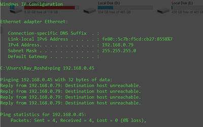

I have tried multiple versions of the H7 package ( 1.12.1 - 1.12.0 - 1.11.1 - 1.11.0 - 1.10.0 ) and tested various configurations without success. The ping command consistently results in "destination host unreachable."Could anyone provide insights or suggestions on what might be missing or misconfigured?

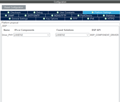

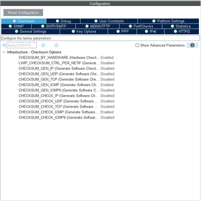

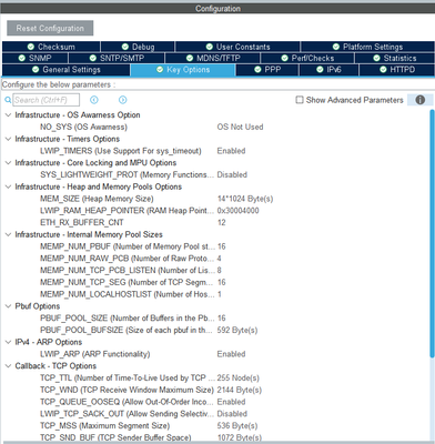

LWIP configuration :

2) LWIP->Key Options-> Heap and Mem..->MEM_SIZE=1600

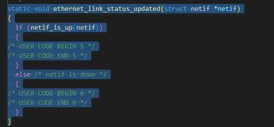

But after this addition, the netif_is_up(netif) in ethernet_link_status_updated shows always that the netif is up, event though the cable is not connected. Or is there another place, where I should check if the netif is up?
2025-01-22 5:44 AM
Hello @KKonn.1 ,
if you want to check the status of the link you should right your own user code in the dedicated user code begin 5 and user code begin 6 areas in lwip.c ethernet_link_status_updated function definition:
Regards

static void ethernet_link_status_updated(struct netif *netif)
if (netif_is_up(netif)) //This is always true after being called from MX_LWIP_Init()
/* USER CODE BEGIN 5 */
monitor_task_set_led(LED_ETHERNET, ON); //This is where we end up!
/* USER CODE END 5 */
else /* netif is down */
/* USER CODE BEGIN 6 */
monitor_task_set_led(LED_ETHERNET, OFF);
/* USER CODE END 6 */
