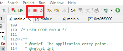

I mean stop the debug session and don't run the example from button 3 in your previous screen shot.
Just upload the program of CM4 and CM7 the debug session with this button:
Then reset the board or simply disconnect and reconnect the STLINK cable.

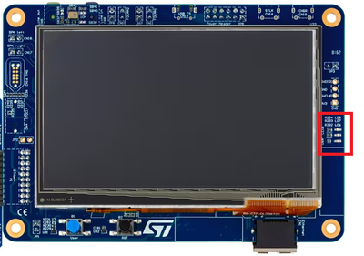

That's really strange:
Are you sure what you are seeing is one of these LEDs (in the red rectangle) is not toggling ?
2025-01-07 6:18 AM
Unfortunately, I don't see any LED toggling in these rectangle...

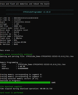

I have download these file: https://www.st.com/resource/en/compiled_demos/stm32h745i-disco_demo.zip
and I have launch "program_hexfile.bat" with the following output
But the screen does not show anything, only a white screen...
I wonder if the board is broken. It is strange to be able to program it without error.
Is it posible that the core is OK but the periferics are boken?
