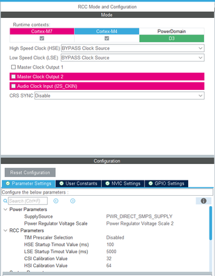

Thank you @mƎALLEm,
I have started a new project with the option "Start My project from ST Board". I can see that in System Core -> RCC the following information
I can see in the main.c that this information is the same:

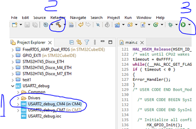

2025-01-07 4:21 AM
I think yes.
1. I select the CM4 file
2. I click on the hammer in orther to build the CM4 project
3. I click on play icon
After I can read in Console <terminated> USART2_debug_CM4 download verified successfully
I do the same for CM7.
After programming both cores I push the reset button but nothing happens.
Am I doing the right steps?
Thanks.
