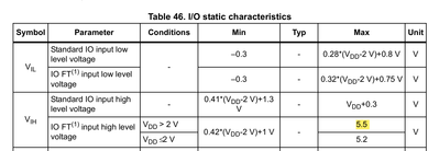

> is it better to run this signal through a level shifter or does it not matter since the pin is "5V Tolerant"?
If you stay within the recommended operating conditions of the chip, no additional hardware is needed. The "absolute maximum ratings" are NOT the recommended operation conditions.
The max voltage on a 5V tolerant pin is 5.5 V
> using PB0
Note that PB0 is not 5V tolerant. I didn't check them all.
