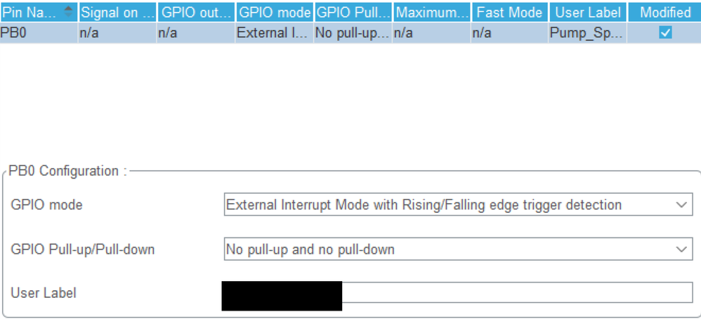

Yes, this answers my question. I am not using any internal pull up or pull down resistor on this pin. It is only being setup as a GPIO Input in external interrupt mode:
2022-02-16 7:20 AM
the 5V signal won't damage the MCU over time?
2022-02-16 7:23 AM
No.
2022-02-16 8:02 AM
As long as the device is powered while 5 V applies!
