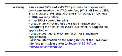

Turns out that page 873 of the 32F417 RM has this note
My interpretation of it is that this is fine provided your code does not re-initialise these pins until the debugger has finished with them.
When they say "disable both JTAG/SWD interfaces" they surely mean when the debugger has finished, because user code has no means of controlling JTAG/SWD.
