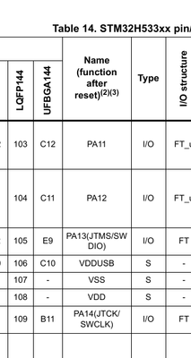

2025-12-14 12:04 AM
You see in ds what pins are after reset: here from H533
Depending on boot0 pin/signal after reset core starts bootloader or user program.
And after power up the debug unit waits for a "key" sequence, to start swd or jtag actions - or stays sleeping/waiting . So you can still connect "under hardware reset" to the debug unit , even if user program would use the swd pins for other functions and so debug impossible , as soon as user program has control and gpio init is done.

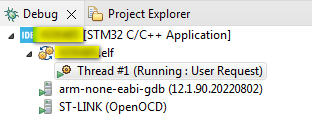

Now let's assume a debugger (which was used to program the FLASH) is still connected. What will that do to the target?
If you have Cube IDE running, the debugger (in ST SWD mode or in the Segger OpenOCD mode) will be interacting with the target, clocking stuff into the long SWD shift register chain and clocking out the CPU registers, etc. Cube shows this
So the SPI1* (remapped to PB3-PB5) will obviously not work.
I can see three scenarios:
1) Exit Cube IDE. This should stop the debugger activity (maybe; the debugger contains a low-end arm32 chip of some sort) but will its outputs go tri-state?
2) Put a mux on the target PCB, activated by a spare GPIO, so that when you set up the AF mapping to get SPI1 to come out, you flip that GPIO pin to switch the mux to disconnect the debugger. The mux will need a pullup on its selector input so that when the CPU powers up, GPIO floating, the mux ends up in "debugger selected" state.
3) Once the AF is changed to SPI (whether the above mux is used or not) the debugger interface will fail and Cube will automatically drop out from debug mode. It never restarts debug mode (you have to do another build-debug with F11) and quite often this occurs anyway by itself.
