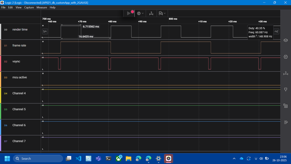

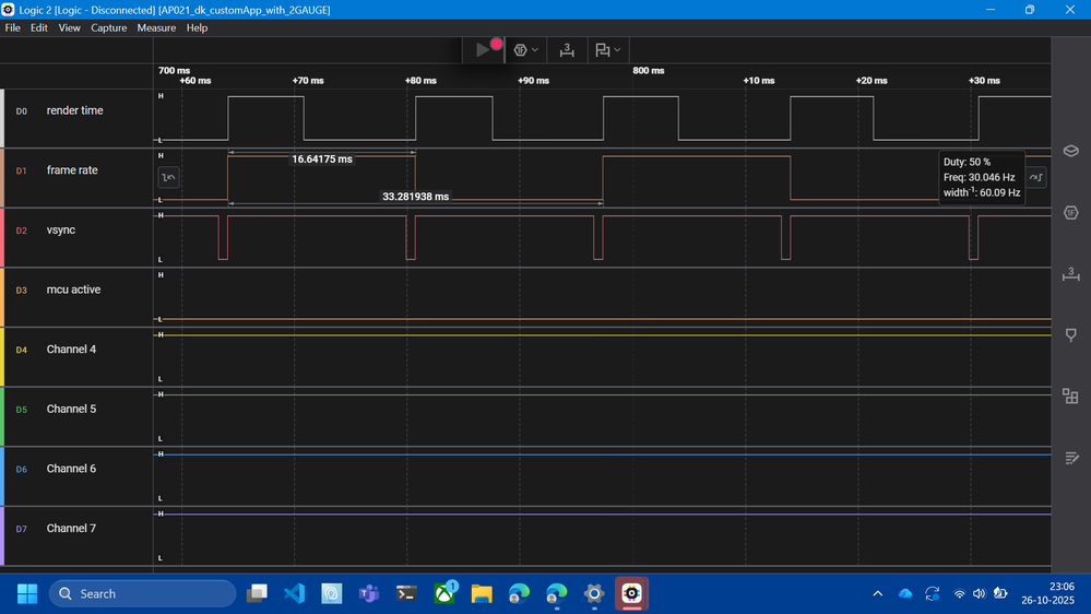

Test1 is an application created for the STM32H750 development kit.
AP021_cb_test1 is an application created for our custom board, which uses the STM32H750IBT6 MCU.
The development kit uses the STM32H750XBH6 MCU.
Please find the attached images of the .sal file, which are the logic analyzer outputs.
Chn0(D0)- render time
Chn1(D1)- frame rate
render time
frame rate

Good day Geethat,
once again, what exactly answer are you waiting from me? These timings look pretty good. Did you have considered things that I have written in my previous comment?

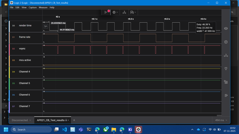

In our custom board, we tested the customized application, and the following behavior was observed:
The MCU signal always stays low.
Rendering time observed is 44 ms on the custom board, whereas it is 16 ms on the devkit custom application. I have followed the same procedure while creating the application for my custom board.

Custom PCB custom application test result:
Showing 44ms rendering time and mcu active low.
custom board custom application results

2025-11-07 1:12 AM
Hello Getthat,
I do not understand what MCU signal stays low and why is it so important. For the rendering time I have already answered: you are using display with a 2,5 times higher resolution that on the kit so the rendering time is higher accordingly.
