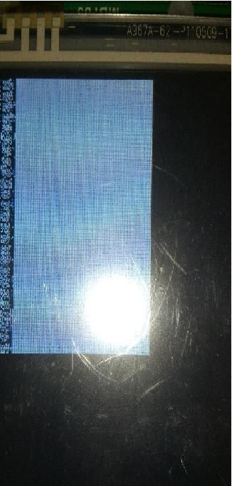

Hi everybody. I'm trying to display a bmp on 3,2'' TFT by using FSMC and stm32f4 graphic drivers. I've done writing some texts changing backcolour drawing pixels but when I want to draw or drive a bmp file with LCD_DrawMonoBMP or LCD_DrawColorBMP functions LCD shows me just white with some noisy white image. I added the screenshot. I need some help. Thanks a lot..

Thank you fm. I can draw primvites. But when I want a draw/send a bmp file to the LCD, program is branching to the HardFaultHandler and display shows just white pixels.
void G_LCD_On_Init (void)
{ GL_LCD_Init(); GL_SetTextColor(0xFFFF); GL_SetBackColor(0x0000); GL_Clear(0x0000); GL_SetFont(GL_FONT_SMALL); } I'm using LcdHal.c driver functions and I'm callin LCD_DrawColorBMP(''untitiled'', 239, 319, 240, 320); ,bmp file is in the same file with the main.c I try to write just ''untitiled.bmp'' but it's still branching HardFault_Handler but there's nothing on LCD.You might need to provide some more detailed information about your issue.
