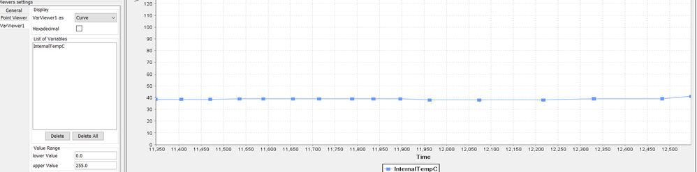

Hi im using a stm32f205retx (LQFP64)
I am measuring 3 adc imputs + Vref + internal chip temp sensor.
The temp sensor is the only one wildly oscillating.
2021-06-22 8:32 AM
Yup that improved the swing from 10º down to 5º or so

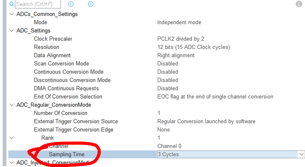

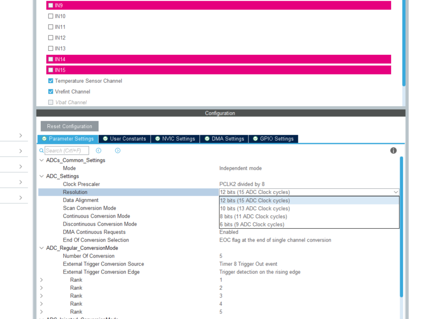

@TDK Because 15 cycles are the max cubeMx
is allowing me to set
2021-06-22 8:38 AM
That is not the sampling time. That is just letting you know how many clock cycles it takes to convert (sampling time + conversion time).
The sampling time can be found in the channel configuration under Rank. The default is 3 cycles (which they should really change to something else).

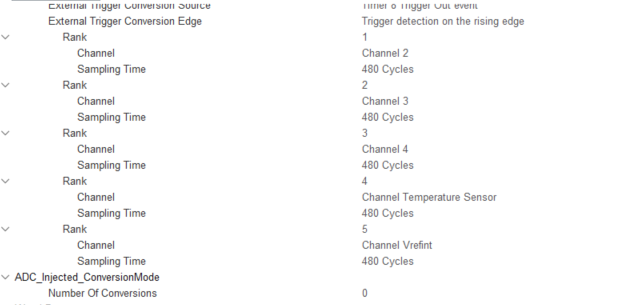

I had them set to 480 cycles ( i forgot about that option) so it looks like is not a clock issue?
maybe its just the junction temp really going up and down due to activity bursts.... as @Community member said
