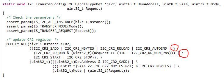

I have 2 questions:
Based on the function below, where do I find the assert_param function? because I want to know how it works.
At the update CR2 register, how the function works? because I confuse why there is a \ symbol and when I try to find where is the function, I could not find it. Is there any reference that I can refer to?

"where do I find the assert_param function?"
Use your IDE's 'Go To Definition' feature.
"I confuse why there is a \ symbol"
That is standard C syntax for a line continuation within a macro definition
It's not strictly necessary here (as it's not the macro definition), but does no harm.

I use STM32CubeIDE and right click, select Open Declaration should bring me to the function. Unfortunately, It does not bring me anywhere. But when I select other functions, It will bring me to the respective functions.
About the question, do you have any links that I can refer to? I want to see some examples also on this matter.
