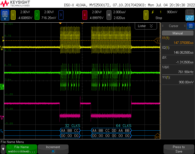

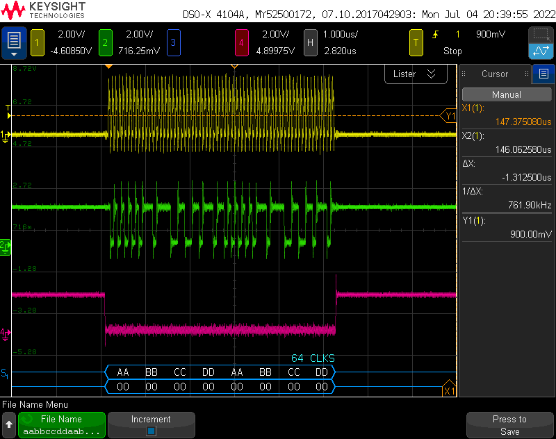

}when I'm running a single SPI transaction using
HAL_SPI_TransmitReceive i have different behavior with different payload size:
when i am use samll payload = "aabbccddaabbccdd" then i get the following:
but when i am using larger payload = "aabbccddaabbccddaabbccdd" then i get the following:
can someone please explain why there is different behavior of the chip select with the number of cycle clocks?
2022-07-04 1:08 PM
For continuous back-to-back transmission, use DMA.
Alternatively, don't use the "automatic" hardware NSS, but set it as a GPIO output and toggle it "manually".
2022-07-05 3:52 AM
thank you for the answer.
what do you mean by "continuous"?
as you can see in the picture only the size of the payload is different.
and for some reason, the first 8 bytes are "connected"
2022-07-05 4:41 AM
The same what you call "connected".
2022-07-05 5:01 AM
hspi4.Init.FifoThreshold = SPI_FIFO_THRESHOLD_08DATA;Those are filled before the transmission starts.
