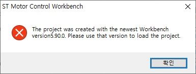

When I open the 'Potentiometer_ESC-G4.stmcx' file through 'Load Project' in 'MotorControl Workbench 5.4.8', an error message as shown in the picture pops up.
2022-09-08 2:29 AM
Please edit Potentiometer_ESC-G4.stmcx and change line 5:
Regards
/Peter
