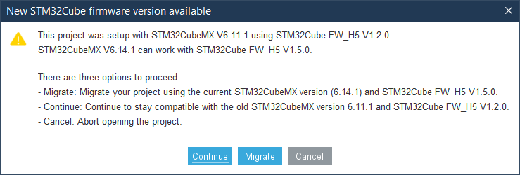

Tried to load an older project in 6.12.0, CubeMx Asked to convert or continue. Selecting continue.

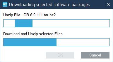

IT start to unzip the tarball and then stops. cube has no error screen, but the log shows as follows
Updating to CubeMX 6.12.1 yields  the  same result. Looked up the tabrall and it can be opened.
Note: With the option MIGRATE could open the project.

2024-09-19 20:55:59,023 [INFO] FileExtend:240 - Unzip File : DB.6.0.111.tar.bz2
2024-09-19 20:55:59,024 [INFO] FileExtend:305 - Tar/BZip2 Deflate
2024-09-19 20:57:03,937 [INFO] LoadServerPackagesThread:196 - End of LoadServerPackages Thread
2024-09-19 20:57:04,074 [INFO] CheckServerUpdateThread:120 - End of CheckServer Thread
2024-09-19 20:57:04,079 [ERROR] MainProjectManager:1100 - Error after a good Download of DB/Firmware Package
