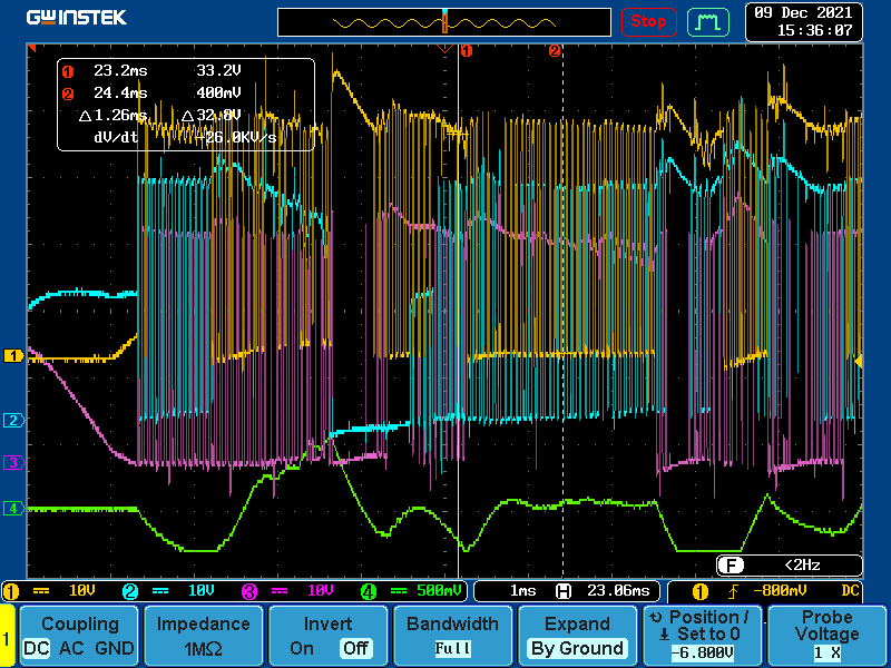

In a very low probability, it will OC when motor starts, and controller (MOS/driver IC) damaged.
Look at the waveform, the PWM duty looks very weired. It's not the same as normal situation.
The PWM duty looks full for couple of cycles and motor will rotate wildly.

Hi, Try to generate a project using the LL library. Describe what's on the oscillograms.

The oscillograms 1./2./3. shows voltage which is output A/B/C, and 4. is the current of output A.
